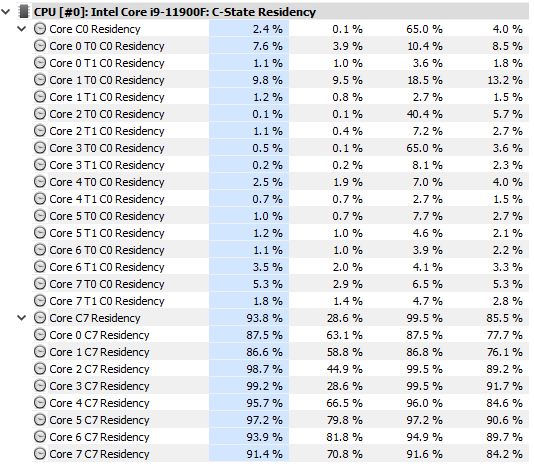

OK, so my current BIOS settings are Auto, Enabled, Disabled:
HWiNFO looks like this:
Switched the setting to Enabled and rerun Cinebench - same score (82 points). HWiNFO:
Basically through the whole test the CPU won't go over 5.0 GHz, just at the very end jumps for a second to 5.1 GHz. Temperature is not an issue, as you can see.
