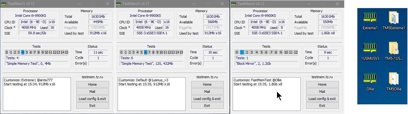

but memtest only has 4 passes in trial version i would do more but i cant or is there any other program ?
Ah, pardon me.
You can use testmem5 with 1usmus profile. You can download program and configs there
Enter program, load config then program will autoclose, open it again.
Administrator required for normal RAM test there
You can find approximate stuff that causes errors for 1usmus and anta_extreme profiles on "data" sheet there
https://docs.google.com/spreadsheet...JV3BjdL-dcfJJeyhdSAoJmuzJE/edit#gid=878090880
1_usmus test errors are more informative though...
Tests 3 and 11 rare synched error can be...

Normal memtest or custom config memtest with 16 tests and with LONG workload...
4 passes usually not very much, test should go at least for an hour or more just to get any result that is less than common failure cause voltage/timing messed up
You may edit config files that are in /bin folder of this program. Set up workload amount (in %) and cycle times...
For 1_usmus long test i either run 300% workload with 30 cycles (5 hours), or 100% workload with 90 cycles (6 hours)
Ah yeah
