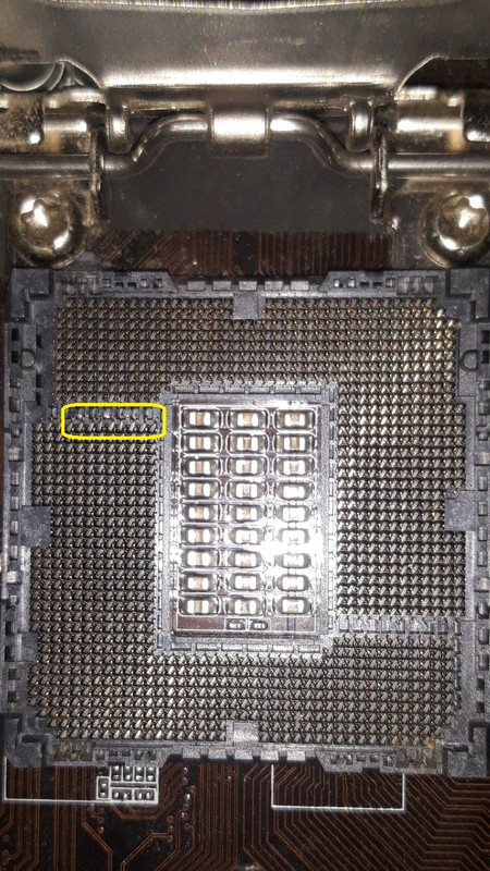

I did notice, now that I think about it, the little (I have no idea what they are called) yellow things that sit on the motherboard underneath the cpu, 1 or two of them looked a bit bent, kind of?
I'm hoping I can re-align it and it will work... i'll give it a try...
(the old CPU (I5'4460 doesn't seem to start the computer neither, but it was all fine before I tried to swap them)

Here are some images
1:
2:
give a closer look of this part I did notice, now that I think about it, the little (I have no idea what they are called) yellow things that sit on the motherboard underneath the cpu, 1 or two of them looked a bit bent, kind of? that where your issue could be if you could made a zoom of it as picture .
