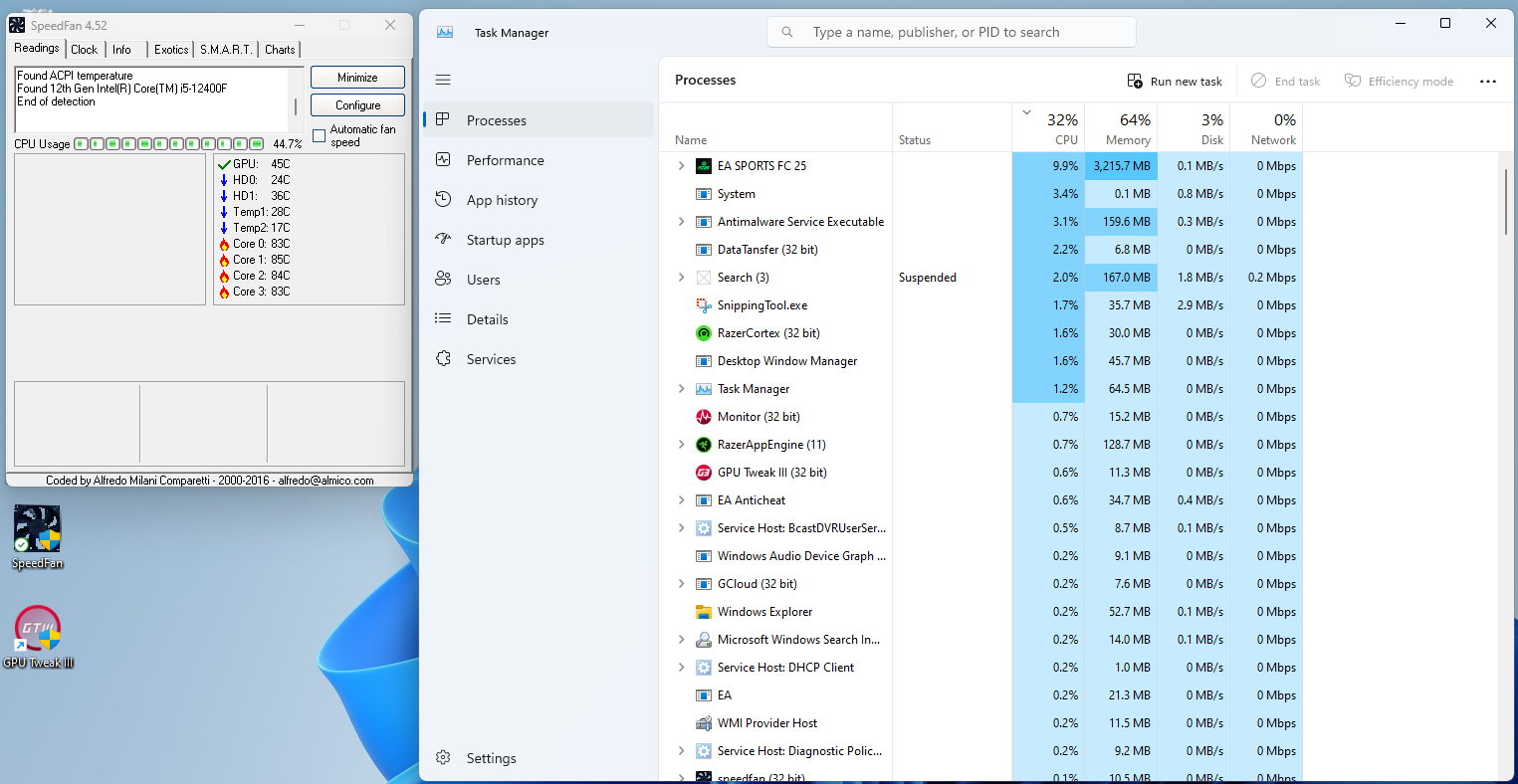

Here are the screenshots illustrating the problem:-
High temps after playing FC25 for a random amount of time (fans full speed, system idle process at 99%)
Hi temps after rebooting PC and not playing any games (fans full speed, system idle process at 99%)
![hitemp.png](/proxy.php?image=https%3A%2F%2Fwww.gravity17.com%2Fhitemp.png&hash=d1649ae5ea51024c907c96ffecdd317f)
![hitempreboot.png](/proxy.php?image=https%3A%2F%2Fwww.gravity17.com%2Fhitempreboot.png&hash=143803cb3005f1b1bca182d75467854a)
