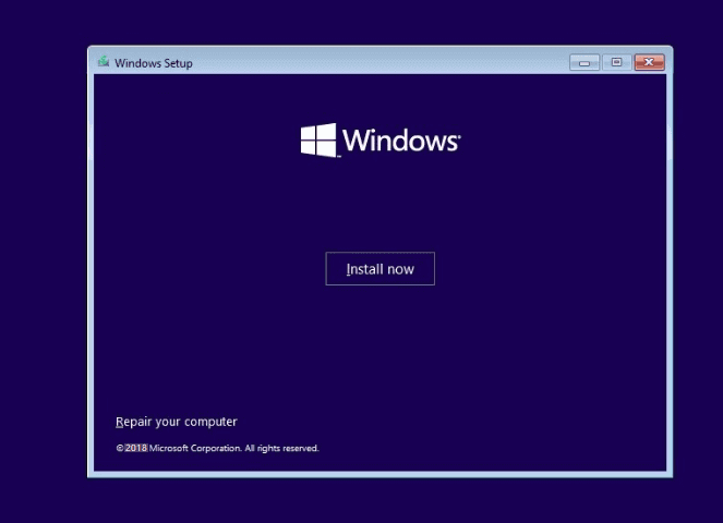

Step 1. Boot from the recovery USB or the original installation DVD.
Step 2. Move to the install screen, and click Repair your computer.
repair your computer

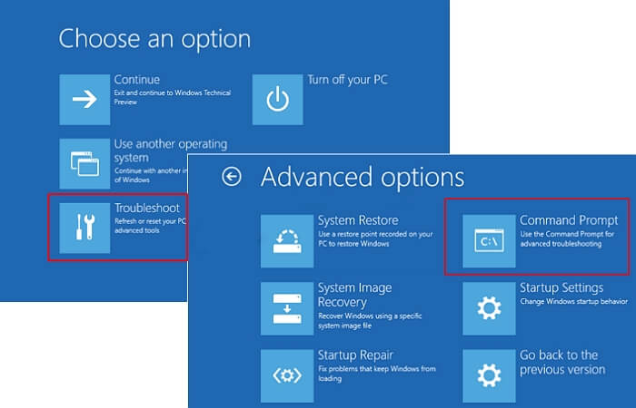

Step 3. On the Choose an option screen, choose Troubleshoot > Advanced Options > Command Prompt
rebuild or fix mbr in windows 10

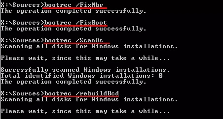

Step 4. Input the command lines and press Enter each time:
  • bootrec /fixmbr
  • bootrec /fixboot
  • bootrec /scanos
  • bootrec /rebuildbcd

Okay so I just tried those step your said.
Bootrec /Fixmbr
Completed successfully
Bootrec /fixboot
Access is denies
Bootrec /scanos
Total identified windows instillations: 0
Bootrec /rebuildbcd
I will now try the other process you said about taking out the 2tb and doing a fresh install. Unless you’ve got any other ideas from those result?
