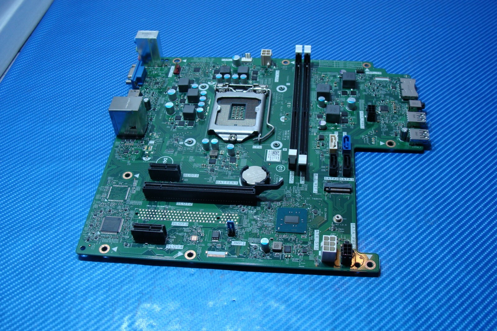

It's a little unconventional, but that board could be migrated to a new case - provided you account for the overhang on the right.
Front panel connectors would likely get interesting, but should be doable to set up.
You'd need a 24pin to 6pin adapter to utilize a standard PSU, but those are cheap:
https://www.ebay.com/itm/24-To-8Pin...248604?hash=item547de27f5c:g:tnkAAOSwerZeJrRI
Looks like the board would need an ATX case....
