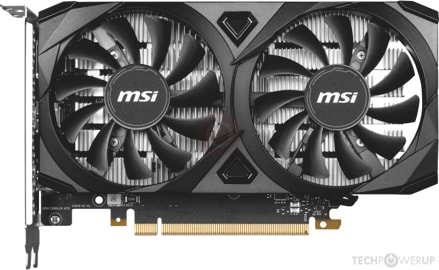

I'm getting mixed information about this card, some versions are labeled as OC (Pre-Overclocked) while others are not labeled with OC, for example "MSI 3050 VENTUS 2X 6G OC" vs. "ZOTAC 3050 6GB GDDR6 Solo"
in their websites it is mentioned that they both consume 70W, does that means that the ZOTAC one is also OCed? or maybe the MSI would still consume more power? in this case how much more exactly, Thanks.
https://www.techpowerup.com/gpu-specs/zotac-rtx-3050-solo-6-gb.b11703
show both to have a 70W TDP. The only difference would be their boost clock speeds.
Nice note sir, so the boost clock for the ZOTAC is 1470 MHz, while for the MSI it's 1492 MHz (+1%)
but how is it possible for that +1 percent performance not to draw more power!
these cards can be a good choice for PCs with little PSU juice since they require no power cable, so if a PC has a PSU of let's say 350W, that +1% would make a difference, and i know you can just get a LP one and rest your mind from all this, but in some areas of the world the MSI might be the only one available / the cheaper one, so i'm guessing it's either the ZOTAC uses less than 70W or the MSI uses just a little bit more, but if so how much exactly more is it 5W? is it 10W? I just would like to have the correct information before recommending it to someone.
