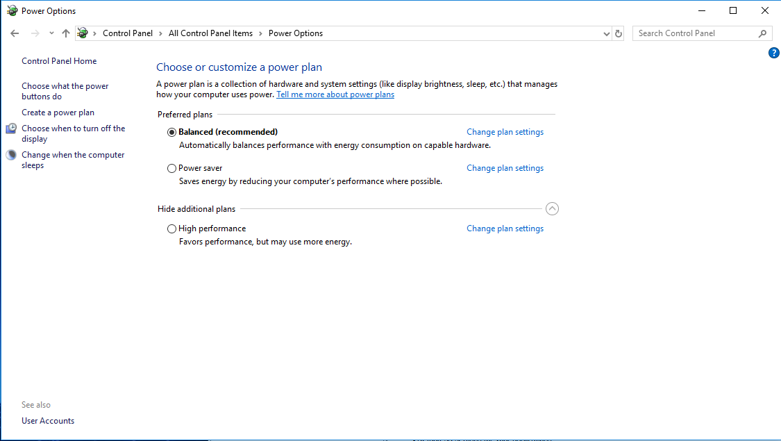

Just in case you aren't sure how to make sure you are running in high performance mode in Windows:
Simply navigate to power options in control panel, then if you don't see high performance mode as an option, click the little arrow that says "show additional plans" and you should see high performance mode.
Switch to it and feel free to modify it's screen timeout and system sleep settings to your liking.
(I personally always put them to never)

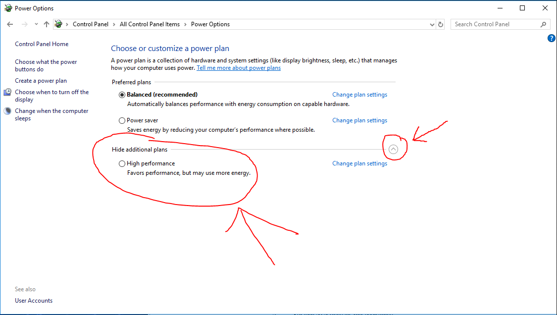

Also where is the arrow. I did what you said to do and my monitor is still using the iGPU.
the arrow is plain as day in my image for Windows control panel.
