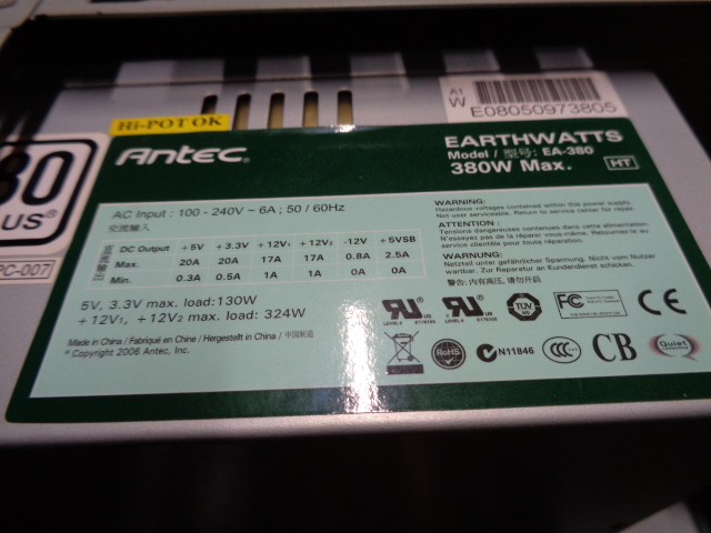

Earthwatts EA-380 PSU
How old is the PSU? Must be 14 years old by my calc's.
Then I pulled the 24 pin plug off the MB and did the "paper clip" jumper between pins 15 & 16. The PSU fan came on. (very quiet PSU, so not much noise).
The paperclip test is flawed, it doesn't tell you how much power the PSU can effectively output to the entire system and you're also told to induce a load with something like a dead HDD or a fan(so a minimal load can fire up the PSU).

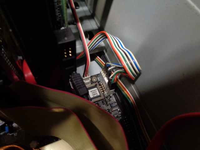

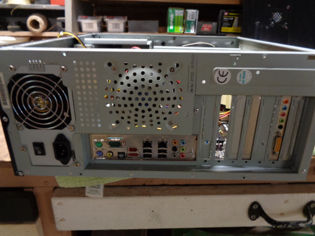

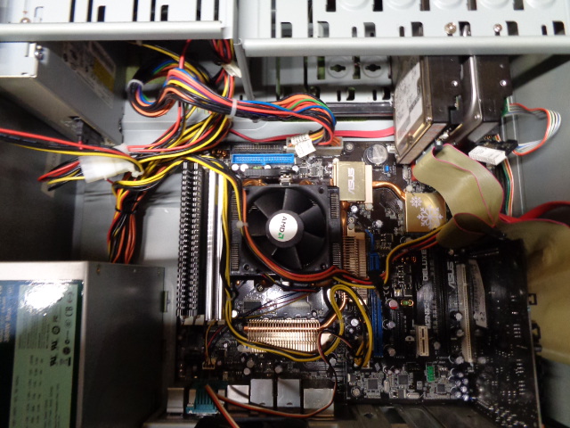

Anyway, I did take some poor quality photo's as well.....
dsc00563-jpg.1550
dsc00565-jpg.1551
dsc00566-jpg.1552
dsc00562-jpg.1549
