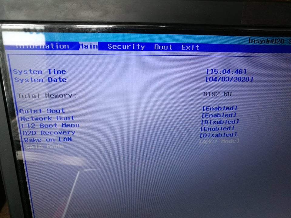

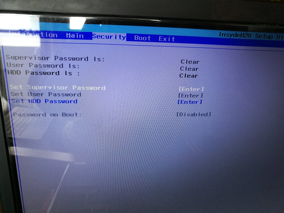

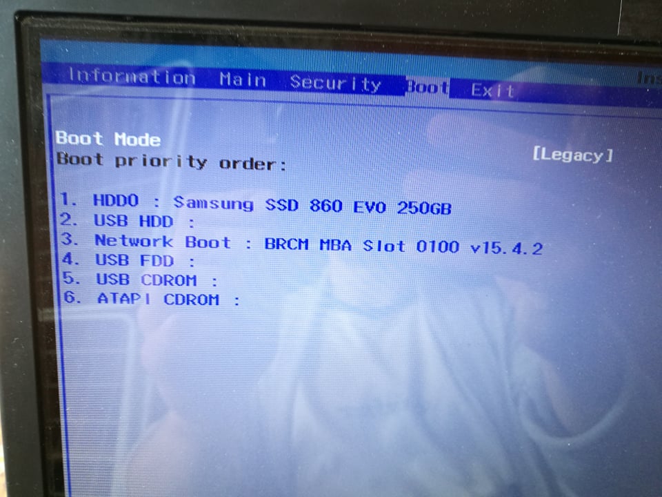

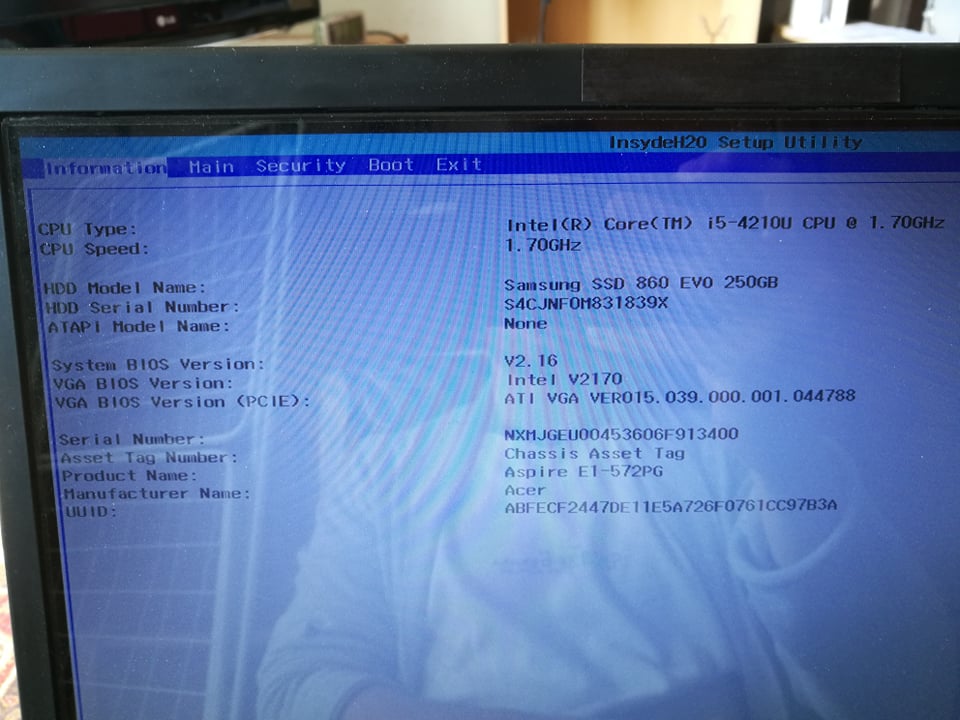

The HDD works perfectly (mostly, I'll explain in a bit) as an external device from any machine I connect it to. I've read thing about enabling ATA/SATA in BIOS, however the options in my BIOS are not a lot, there's not too many things to mess around with (see attached images).
Things I've tried:
  • setting the boot load order (images attached)

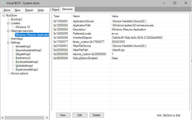

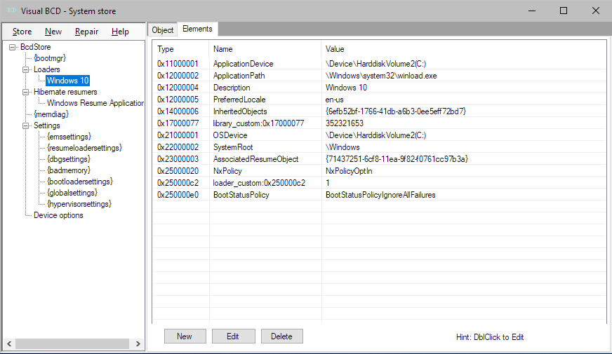

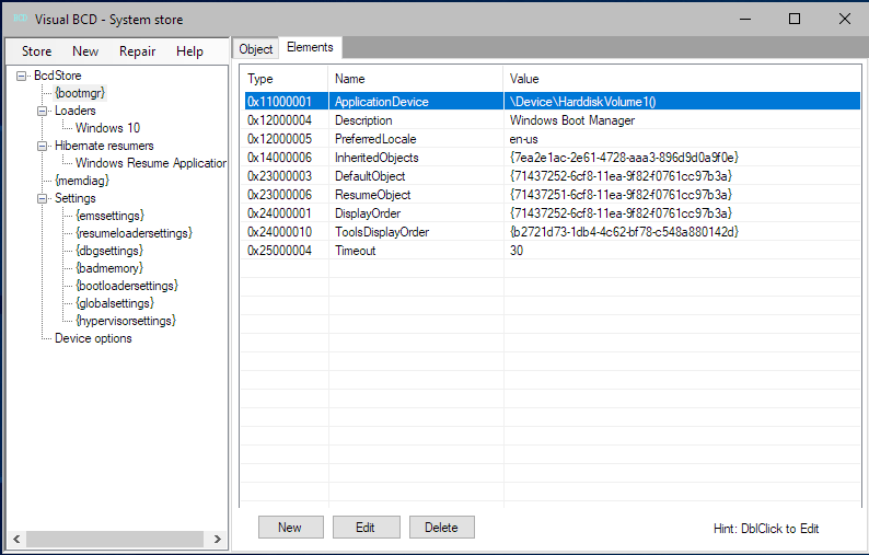

  • with VisualBCD: repair boot, repair BCD (images attached about information it showed about the system)

- BIOS
- VisualBCD (information)

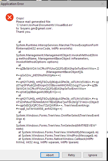

an error I got from I think repair BCD:
- Windows Information Viewer
the volumes that are shown by VisualBCD
- bcdedit
result

i would suggest doing a fresh install of Windows and reinstalling the updated Acer system drivers from the product support web page(s).
you have SATA [AHCI] mode enabled in your BIOS, so that's not the issue.

AHCI mode is the only option actually.

UPDATE: I might have mentioned that the system won't even start booting, however that's not actually the case as I recently discovered, that quiet boot is enabled in BIOS, which means instead of showing the white text on black screen, it shows the Acer logo. So the booting sequence starts, but hangs.
