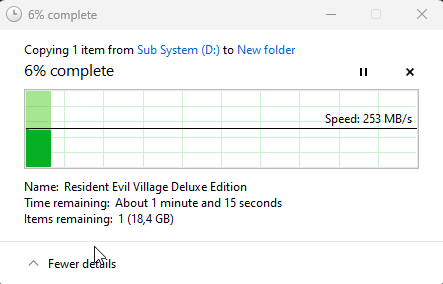

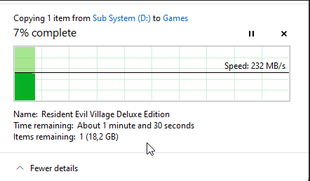

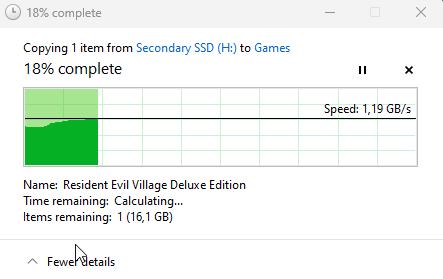

The problem is whenever I copy files from my CS2140 to somewhere else (even to its own directory just a different folder), the file transfer speed is limited to 250MBps only

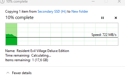

While my CS1031 has normal speed when I do the same thing
Also i made 2 partition of the CS2140, 500GB for System C and 500GB for Disk D, i dont think its affect it but i kinda sus because it has boot system on C 🤷‍♂️
tldr;
copying files from
CS2140 to CS2140 = 250MBps > https://marinska.s-ul.eu/Lak5xaGo
CS2140 to CS1031 = 250MBps > https://marinska.s-ul.eu/6paAqLPr
CS1031 to CS2140 = 1.2GBps > https://marinska.s-ul.eu/1w3VwrYk
CS1031 to CS1031 = 700MBps > https://marinska.s-ul.eu/BMWJoUJv

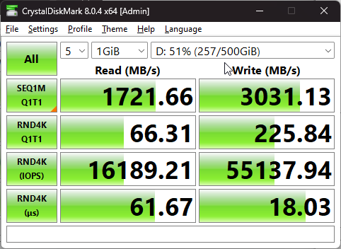

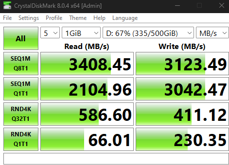

somehow my CS2140 has limited read speed when everything is normal on CrystalDisk Mark (3400MBps Read and 3100MBps Write) > https://marinska.s-ul.eu/IXTG3Vu8
Is this because my CS2140 has a faulty hardware or there is an unusual setting I need to do or there is another issue
Thanks in advance

I had to collate into a single image, to get a handle on it:

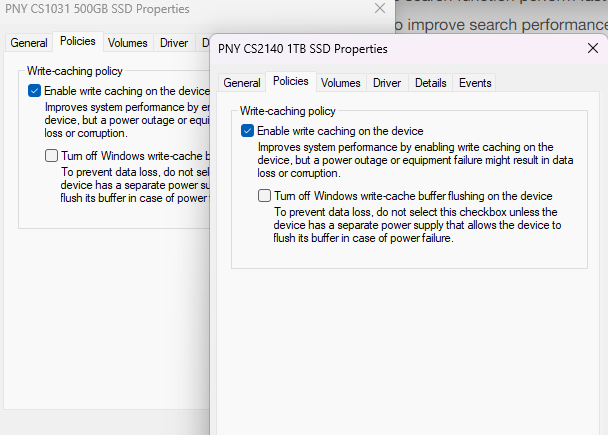

Is write cache enabled on both drives?
