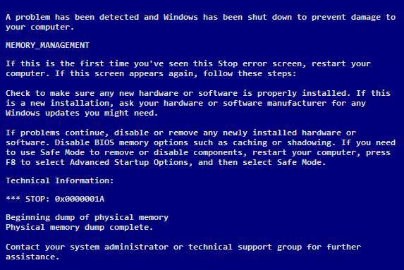

So, about a month ago I spilled some liquid in my case, and after cleaning everything up I started to get the memory management bsod, most often when playing a game. At first, I figured my memory went bad, so I replaced it with these sticks to see if the problem would be fixed.
I ensured that all of the timings and voltages were correct in bios after installation, but alas I still got the memory management bsod.
Then, I figured that the dimm slots on the motherboard had gone bad, so I replaced my old motherboard
with this one, and went ahead and replaced my processor with this. However, after I installed my components, reinstalled Windows 7, and loaded drivers from my motherboard cd, I once again got the memory management bsod on the desktop.
The only things I believe could be causing this is either faulty ram that I just purchased, or a bad power supply. I will run memtest86 this evening, but I'd like to hear from you guys what you think could be causing this, because it's getting old fast.

Well, after updating all of my drivers and setting the correct timings in BIOS, my blue screens seemed to go away for about a week. Then, I started getting stop messages that I haven't seen before, and then I started getting MEMORY_MANAGEMENT once again. My PSU/HDD are both ~4-5yrs old, so I'm thinking maybe those could be the culprits, but I'm no expert. Here are some of the dumps:
