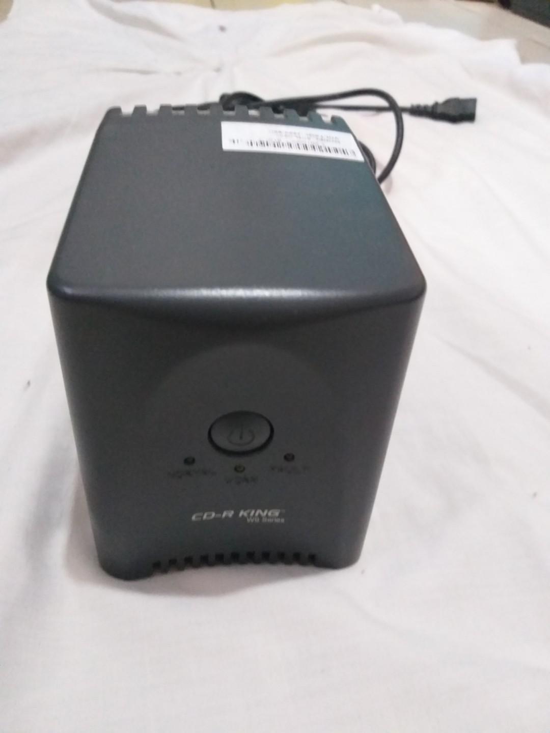

Now that i think about it, could an AVR be a problem? the AVR is almost as old as the PC case at this point and has seen its fair share of power outtages across the years i and previously my dad had it.
https://media.karousell.com/media/photos/products/2019/06/19/avr_1560940062_1e0c00c8_progressive.jpg
You can source the installer for your OS off of Microsoft's site, using Windows Media Creation Tools. Much of the issues with BSoD's come from a corrupt installer or using the wrong drivers, or letting the OS source drivers it thinks is right. The latter part is where we advise people to manually install all relevant drivers for your platform, in an elevated command, i.e, Right click installer>Run as Administrator.
I pointed towards the PSU since the issue stems from being taxed during a game, which demands more from your platform(namely GPU).

I also found out that i have a very OLD AVR my PSU and Monitor hooked up into. Its almost half a decade old i think, and has seen plenty of blackouts and brownouts from my dads pc. https://media.karousell.com/media/photos/products/2019/06/19/avr_1560940062_1e0c00c8_progressive.jpg

My AVR is from a cheap company apparently, CDR King, it also has my monitor and 2 other plugs plugged into it, the thing is i dont know how much wattage or voltage this avr has, its legit just a plastic box from my perspective.
