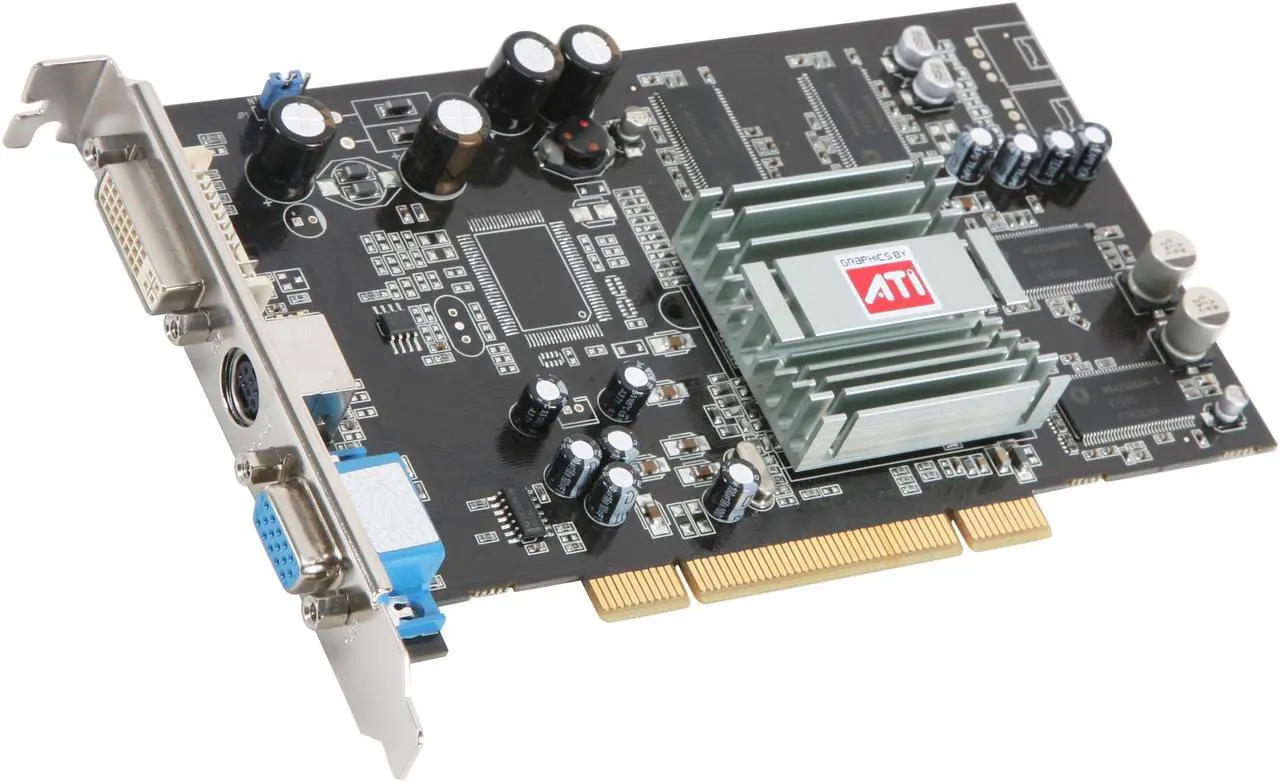

Check the edge connector on your video card carefully. It might be PCI, AGP or possibly PCI-Express. This will help when looking on eBay. I recommend buying old cards only if they are descibed as "working".
The interface (gold-plated edge connector) must be correct, but you could probably use a card from another manufacturer with a similar specification. This assumes your old card has died as seems likely.
PCI card:
https://www.newegg.com/sapphire-tec...256mb-graphics-card-fanless/p/N82E16814102533
