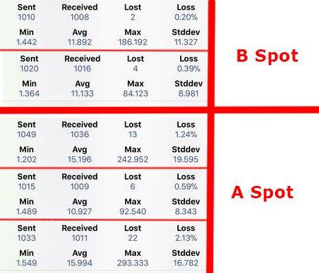

So I did some ping test as per below

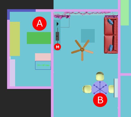

Below is my house layout, where i sit during the ping test.
A & B is where i sit during the ping test. M is where the modem located. pink color are the walls. the rest are my furniture.

1- is the problem really indeed router problem? (I'm suspecting router but i'm not confident enough to say it is, coz my game play is really smooth. zero lag or delay & no drop frame)
2- If it is, any router that be recommended? I need to sit at spot A to play as my computer and stuff is there. If any obstacle between me and router would be minor distance, wall, desk, & monitor. Hopefully can meet my budget around 100USD. preferably below that.

Not sure what "better" router you think there is. The wifi communication will negotiate the best connection based on the feature of the router and your end devices. Your iphone only has 2 antenna so it can not do better than 2x2 mimo anyway. The router you currently have is 2x2 mimo. So both device will use either 300 on 2.4g or 867 on 5g.
A different router even if it supports more will just drop back to these speeds anyway.
The distance the signal goes is based on transmit power and that is regulated by the government. Almost all routers put out very close to the maximum legal transmit power. I don't know about your phone but most phones but out less than the legal power mostly to try to save on battery. So...

As long as you are connected to 5GHz WiFi you should be fine as long as you aren't cranking your mirror app quality settings to insane levels.
Set the mirror app to 1080p and adjust the bitrate/quality until it smooths out.
Your PC should be connected via Ethernet, and if it's not, you should be on 5GHz with it as well to try and minimize any stutters.
And yes, internet speed is the speed at which data can move in volume across the world to you and back again and pertains to your connection to the outside world provided to you by your ISP.
When it comes to data speeds and latency over your home network between devices on your router, that is determined by your devices capabilities, the connection type to the central hub that all your devices connect to (i.e. the router and WiFi vs Ethernet) and the hub itself and how well it handles things. (depending on the case, software on devices can also play a role)
Wifi should be your last choice when you want quality and performance. You want as much as you possibly can connected via ethernet cables. What you are doing is almost a worst case option for wifi.
Wifi unlike any other media retransmits data when errors are detected. The takes time and causes small delays. Both online gaming and live video stream/mirror would much prefer that damaged data just be dropped. They are extremely depenent on data being delivered at consistent rates. Pretty much any other application can use buffers to hide the retransmission delays to some extent but you can't do that when you are dealing with real time data where adding a 1second buffer would cause issues.
Most wifi issues are caused by interference. It can be your own devices that attempt to transmit at the same time because wifi is half duplex. You might be able to solve that by putting some of them on 2.4g and others on 5g. The much more common cause of interference is signals from your neighbors wifi which you can do nothing about.
Then again this mirror and capture software tends to have many issues on its own so it may not even be a wifi issues. Another good reason to test on ethernet if there is any possibility.

Yep, i am on 5GHz wifi.
and my mirroring app quality is not that high. i only mirror 1080x720p.
Tried both "D3DX" and "OPENGL" render mode, does not improves.
Yes, my pc is connected via ethernet. I think the choppy and lagging part is during mirroring.
Base on streaming data, there is no drop frame, bit rate is consistent at value i set.
If i understand your last paragraph correctly, i guess is very likely the router and wifi capability is the problem for my case?
The distance the signal goes is based on transmit power and that is regulated by the government. Almost all routers put out very close to the maximum legal transmit power. I don't know about your phone but most phones but out less than the legal power mostly to try to save on battery. So if it is some kind of coverage issue it will be the phone not the router that likely is the cause.
Maybe 802.11ax so called wifi6 might work better but your would have to have to replace your phone with a model that supports it. It is suppose to work better to share bandwidth and it also uses more bandwidth so it should be faster. This is very hard to say not a lot of people have moved to this technology yet so you do not know what the common person gets.
