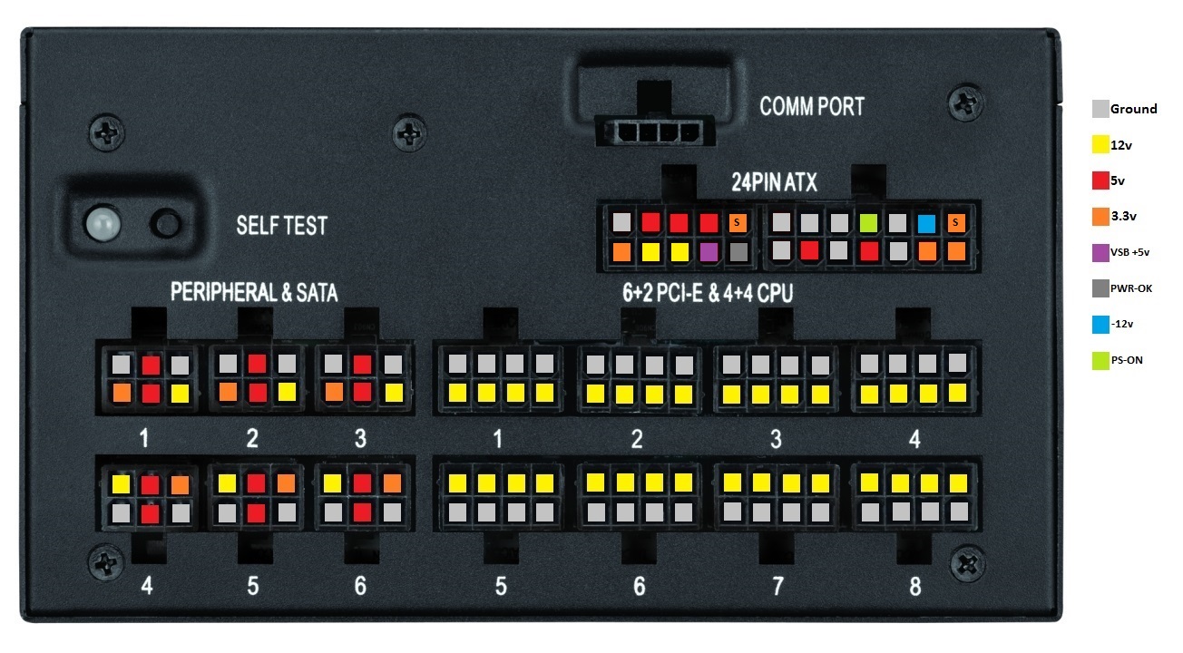

http://www.evga.com/articles/00803/
http://www.overclock.net/t/1420796/repository-of-power-supply-pin-outs
Please note that the AX860I, 1200I, and AX760I all have the same pinout!
Here is the specific information. I have no idea.
Modular power cables , and pinning on the PSU side are NOT interchangeable, generally. We changed PSU from Chieftec to Corsair yesterday, assumed they were interchangeable and blew 2 HDs and a DVD-drive because 5+ and 12V are swapped at the PSU side.
Take care!!
