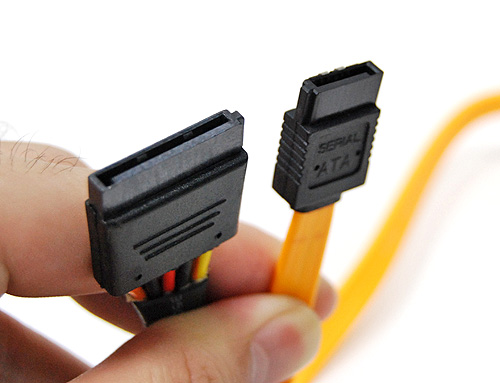

Hi, I pushed the cpu cable further in and the monitor turned on (thank you very much) however, when it turned on I am now greeted by the message of Reboot and select proper boot device or insert boot media in selected boot device and press a key. How do I get past this? Could it be my data cables or cables to the had?
Double check that power is going to your HDD. If you don't have data or power, the PC won't have anything to boot from as the HDD won't be detected.
