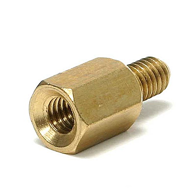

This is a motherboard stand-off. If needed, they should have come with your computer case. They screw into the motherboard tray and your motherboard is screwed into these. They create separation between the bottom of your motherboard and your motherboard tray to prevent short-circuits like the one you describe.

Interesting. I did not see those screws. However when I did screw into it. it looked goldish. Maybe its already mounted on the case? How would i be able to know?
It's possible they were pre-mounted. It's also possible that the motherboard tray has raised mounting points The only way to know for sure is to remove the motherboard and see what you did. Also, let us know the exact model of your PC case.
-Wolf sends
No need to undo anything. That case has pre-install stand-offs (yes, the gold-ish screws). So as long as those are there, you didn't likely short out the motherboard.
Next, I'd recheck your wiring to make sure everything is properly connected and secure.
