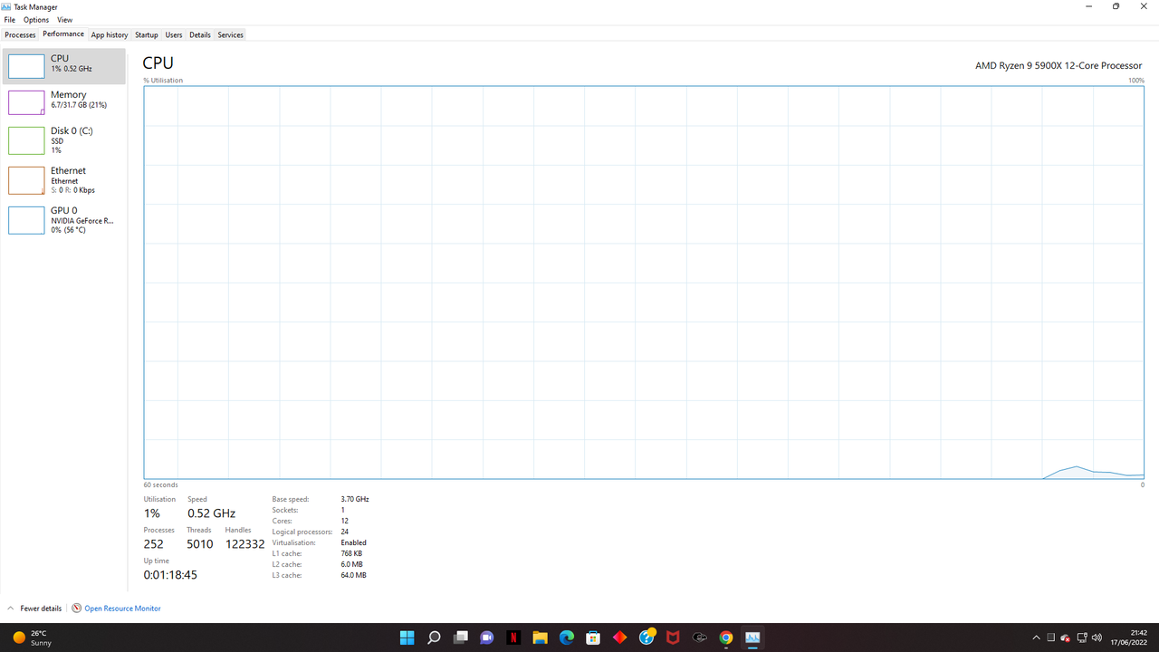

Going to need more info on CPU temperatures other than "OK." This looks like a heavily throttling CPU (look at the Turbo clock rate). Watch the CPU temperature as you start to use us and report the temperatures.

https://i.postimg.cc/qvJHzfzW/Screenshot-1108.png
That is a screenshot of my CPU in Task Manager and CPU vitals in my Omen hub

I don't know what to open to help show you, open YouTube maybe? I say that because they are the temps you're seeing as my system is currently sluggish. Everything is slow as I take the screenshots for you. Even as I opened the OMEN hub to take the screenshot it was very slow?

https://i.postimg.cc/ZRKKRgvj/Screenshot-1148.png
I have Solitaire open, YouTube, Anaconda Prompt, Task Manager and Omens gaming Hub open
Each one took forever, one by one waiting for them to open.

Again, the CPU here is basically at idle.
