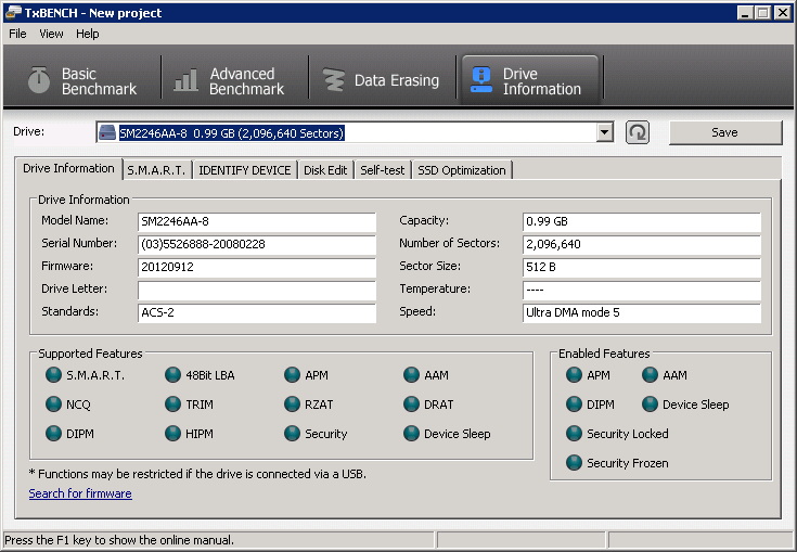

Your efforts are destined to be pointless.
Here are some "ROM mode" screenshots for various flash controllers:
http://vlo.name:3000/hw/ssd/rommode/
These are Silicon Motion SM2246EN and SM2246XT controllers:
http://vlo.name:3000/hw/ssd/rommode/sm2246en_rom.png
http://vlo.name:3000/hw/ssd/rommode/sm2246xt_rom.png
"ROM mode" is a kind of safe mode that the controller falls back to when it can't complete its power-on self test, or if there is a problem with its firmware. Professional data recovery tools utilise safe mode to upload their own firmware and recover the data. There are two test points on the PCB which are momentarily shorted at power-on to invoke ROM mode.
To prove to yourself that this is a waste of...

SM is for Silicon Motion, meaning that you have a corrupted firmware and that you need to re-flash the correct firmware. If you tell us the exact drive model, perhaps we'll be able to find a working firmware for your drive. If it still has warranty, you're better off RMAing it though.
The generic model name and the 1GB capacity are indicative of a firmware "panic". Typically this can be the result of a corrupted Flash Translation Layer (FTL) or bad NAND. These issues cannot be resolved with a firmware update, assuming this is even possible in the drive's present state.
To prove to yourself that this is a waste of effort, try retrieving a SMART report with CrystalDiskInfo. You will undoubtedly fail, and this is because the SMART data are stored in a firmware module which will only be accessible when the SSD is in a fully functional state.
