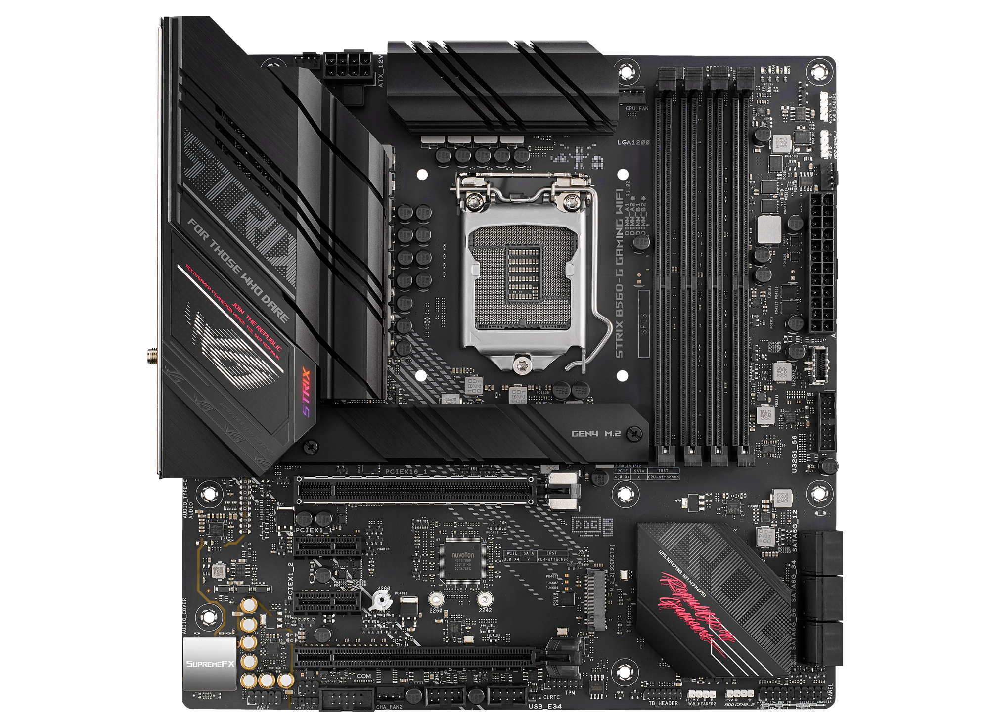

Motherboard is this one:
Which is more than fine.
