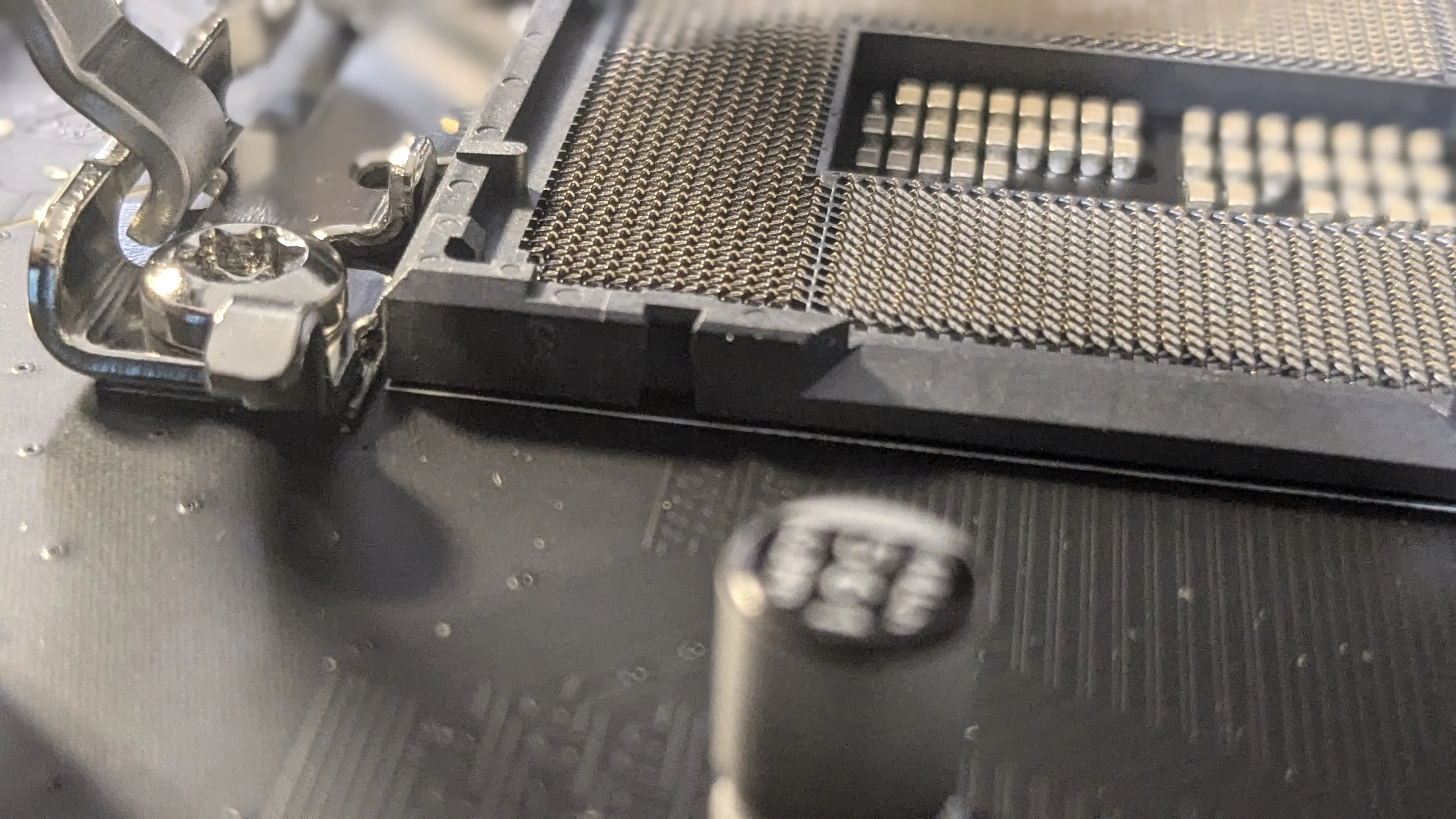

Does it look like the pins are bent?
1000005499-webp.14392
1000005500-webp.14393
1000005501-webp.14394
1000005503-webp.14395
1000005498-webp.14396
For a new build, your thermal paste looks like it's seen years of service making me think your cpu is running very hot! What does cpu temp show in bios? Did you remove protective plastic film from the bottom of the cooler?
Yep that's odd... I did remove the plastic film.
Temps look fine.
Reseating the CPU and the motherboard did nothing...
I really don't know what to do now. I'm not sure whether it's a CPU or a motherboard problem. CPU/RAM/VGA leds still light up one by one, until the "Restarting..." Windows shows up and then it reboots.
