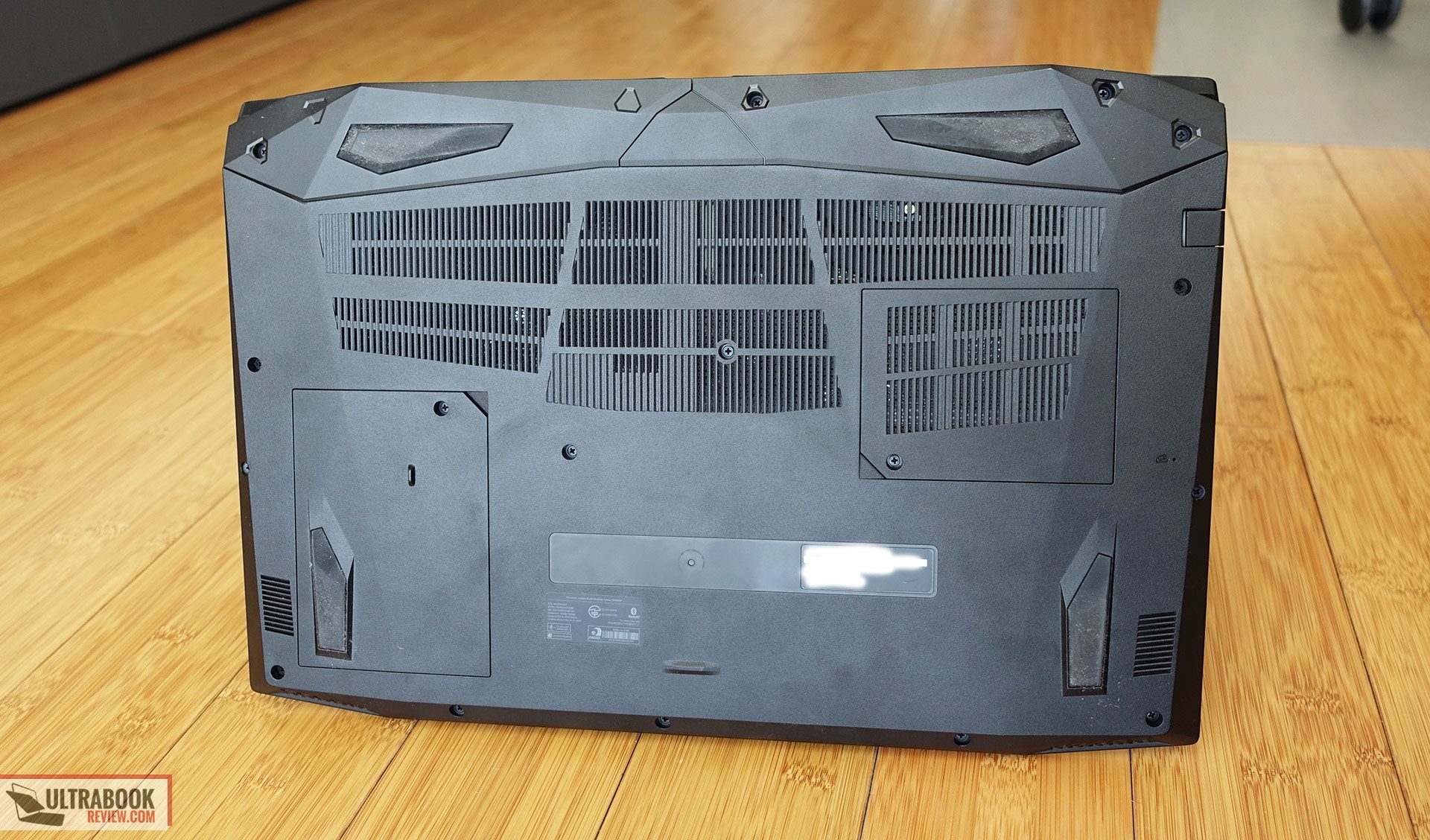

On the underside of your laptop
You should see a pin hole which is used to disconnect the internal battery from the entire motherboard circuitry. While the laptop is disconnected from the wall outlet, you can press on the pin hole. Keep pressed for at least 30 seconds. Then power up with only the battery(not the wall adapter) and take note of the BIOS version for the laptop. o through Acer's support site and make sure you're on the latest BIOS update for the laptop.
You may also want to uninstall and reinstall the GPU drivers and see if that changes the issue. Connect the laptop to an external display and see if the display cuts out on it as well.
