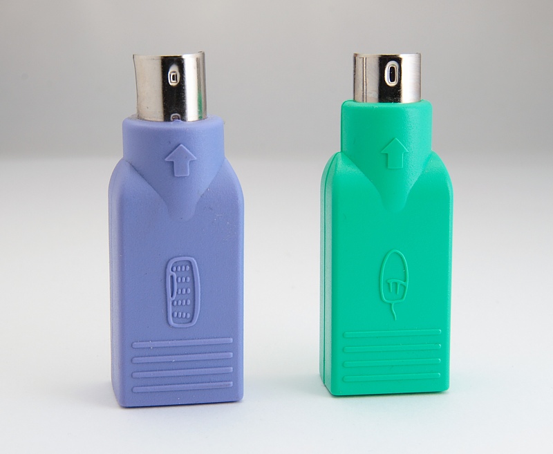

Because the following kind of adapters don't exist, I'm guessing it's impossible to adapt the protocol through a PCI slot, though I don't understand why. If it's a parallel connection, a serial connection should definitely be adaptable. I'd understand the problem the other way around, but perhaps the hardware interrupt is the problem and maybe through PCI, without proper available configurations in the BIOS, this might cause potential crashes.

i realize that you want a perfect solution to your problem but....no, i've never seen or heard of any product which can perfectly replicate the effects of ps/2 on a system without ps/2 capability and i've been actively into computers and technology for quite a long time. i believe the reason for this is due to how ps/2 works which i will list in this post.

it appears that you are correct in that a ps/2 pci card is essentially just a card with a controller which converts the signal to usb.
