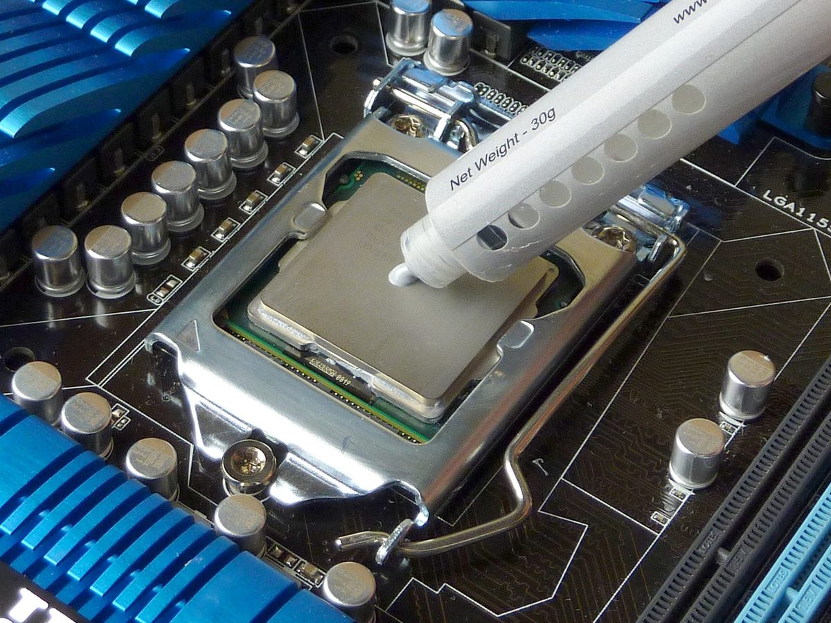

Try using the "Buttered Toast" method for Thermal Interface Application, the Pea method isn't that great compared to the "Buttered Toast" method.
It's been tested to give you the best results by spreading a very thin even layer between above the Heat Spreader.
Ok. I've always used the pea method but not against giving this a try. Will have a look.
