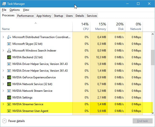

Try the below steps to uninstall Nvidia Drivers
Go to Task manager (Ctrl+shift+Esc)
In Processes tab, select every task related to nvidia and Click on End task
After that go to C Drive and delete the following files
C:\windows\system32\DRiverStore\FileRepository\nvdsp.inf file
C:\windows\system32\DRiverStore\FileRepository\nv_lh file
C:\windows\system32\DRiverStore\FileRepository\nvoclock file
C:\Program Files\NVIDIA Corporation\
C:\Program Files(x86)\NVIDIA Corporation\
Now restart your PC.
After that, perform a clean install. If you don't know how to do it then you can refer this guide https://thewindowscentral.com/nvidia-installer-failed-issue/ to reinstall the Nvidia drivers by clean installation.
