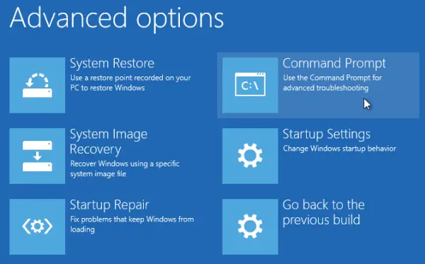

I was able to fix the issue, assisted by ChatGPT.
I created a EFI partition in the new cloned drive, and it worked. First I had to create a Booteable USB drive with Windows11 (I made it with Rufus), lunch it and go into the Fixing Tools of the installation and lunch Comand shell. ChatGPT nailed it.
