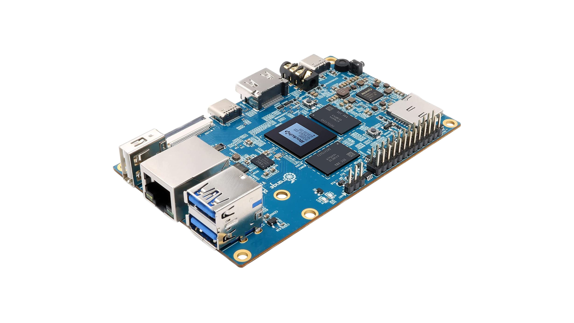

Ugh. Why not at least use Rockchip RK3399? That would deliver 2x A72 + 4x A53.
If I were content with 4x A55, I'd probably go with the ODROID-M1, which uses the RK3568B:
Some benefits being that its M.2 port is PCIe 3.0 x2 instead of 2.0, it has a SATA 3 port and comes with either 4 GB or 8 GB (the Urve board has only 2 GB). Clock speed is also a little better at 2.0 GHz instead of 1.8, but quite a minor discrepancy.
The main selling point I can see for the Urve board is case-compatibility with the Pi 3B.

Whoever created this design wanted the M.2 SSD on top of the board so badly that they ignored the placement of the SOC, which is going to be smack in the middle of the NAND packages, which will kill them. BZZZT.
I think it might be possible to use a M.2. SSD safely with a M.2 extension cable, but the CPU would probably still need a serious manual underclock because the extension cable would prevent you from putting a heat sink on the SoC.
The SoC might not run very hot. However, I found one board featuring the RK3566 which claims it's 22 nm. If you keep the CPU load generally low, it could be okay. Cooling the backside of the board should help, though probably not many Pi 3B cases are setup for good airflow there.
I tend to agree that it wasn't worth keeping the Pi 3B's form factor, unless they had some really specific reason.
