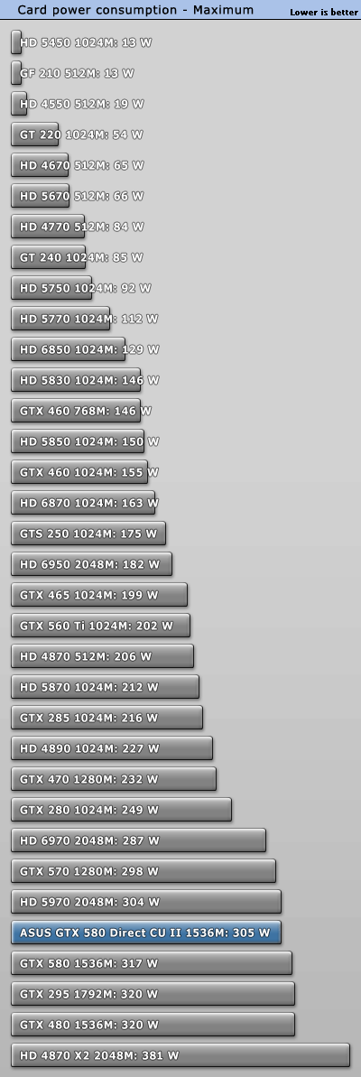

ive checked on http://www.hwcompare.com/9170/geforce-9800-gx2-vs-geforce-gtx-580/
and shows this new ASUS DirectCU II GeForce GTX 580 will run at 47 Watts (24%) higher than my old card.... My old card ran fine for a year... was playing big games with it and even overclocked it...

a word of advice. don't go by "reference benchmarks". its not 244 watts for THAT card but up to 305 watts!
yes, chances are it wont hit that but i am making a point for your sake.
cheers!
That bench is terrible. It has a generic 570 down as pulling 298w, but the TDP (max power) for a generic (reference) 570 is only 219w. This is pulled straight from Nvidia's website. http://www.geforce.com/hardware/desktop-gpus/geforce-gtx-570/specifications
OC cards can pull more, but a stock 570 (what they specified) cannot.

Furmark load, it is all bullcrap.
While you won't typically hit the loads that furmark gives you, I wouldn't call it bull crap as it allows you to see worst case scenario and you can plan for that, if you get a PSU that can handle the max load (with some headroom) then you are definitely fine when not at full load like furmark

This might help explain the discrepancy between TPU's numbers and Nvidia's TDP
http://www.bit-tech.net/news/bits/2010/11/15/nvidia-gtx-580-power-limit-bypassed/1
