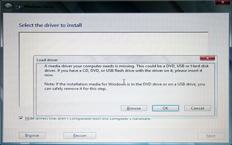

i installed windows 10 iso file and made a boottable usb but when i try to install the os i get message a media drive your computer need is missing ... how can i solve this problem?
Sounds like Windows 10 is not detecting any drives to install to, and you're trying to load a driver for it to find one, but even after loading it, no drives are still detected.
Post your system specs and we'll be able to help further.

This is the error the OP mentioned. This screen in the setup wizard is for loading drivers to detect hard drives or SSD's to install Windows to. If it was an issue with the install media itself, the OP would likely not even be getting to this point.
Edit: The other instance I have seen this issue come up (where there is nothing actually wrong with the drives installed in the machine) is when you try to boot the install media via a USB 3.0 port that is connected to a third party controller. That USB controller doesn't have access to the drives connected via the SATA ports, thus loading the appropriate drivers will not work regardless.
@ OP: That would be one other thing to check... that the USB stick that you're booting from to install Windows is not plugged into a USB 3.0 port.
I've never seen the media itself cause this specific issue, but I'll try setting up a couple with Rufus just in case. Got a couple systems here I can test on.
Edit: Good point. Not having Legacy USB enabled in the BIOS can definitely cause this as well.

yes i have definitely seen the media cause it personally
and somewhere in my best answers are 2 or 3 where rufus was the culprit--though they may have updated it again in the last month or so if lots of people complained about it
if the op replies with some more info though it would help
yeah i used rufus and it's usb 3 but it's not plugged into usb 3 port and i tried to install it with windows 7 update but i alwas get an error message at the end of the installation,and legacy mode is enabled,my system specs are;

Also check if AHCI mode is enabled in the bios.
AHCI mode was ide i changed it to AHCI but this didn't help,so i'll try using yumi
