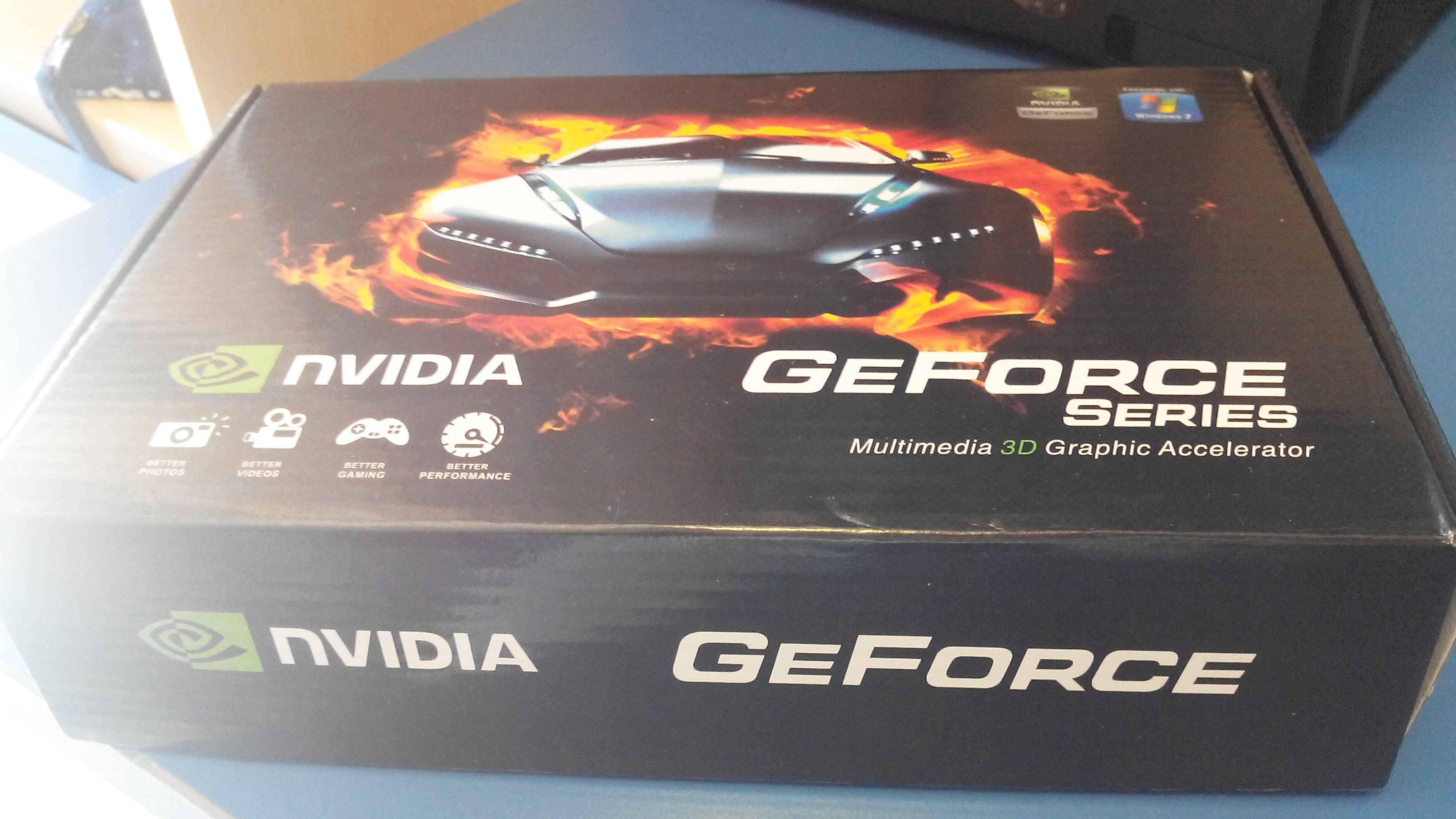

Be careful on the 1GB 750 cards, lots of fakes going around (750 and 750TI).
Fakes look something like this (generally):
