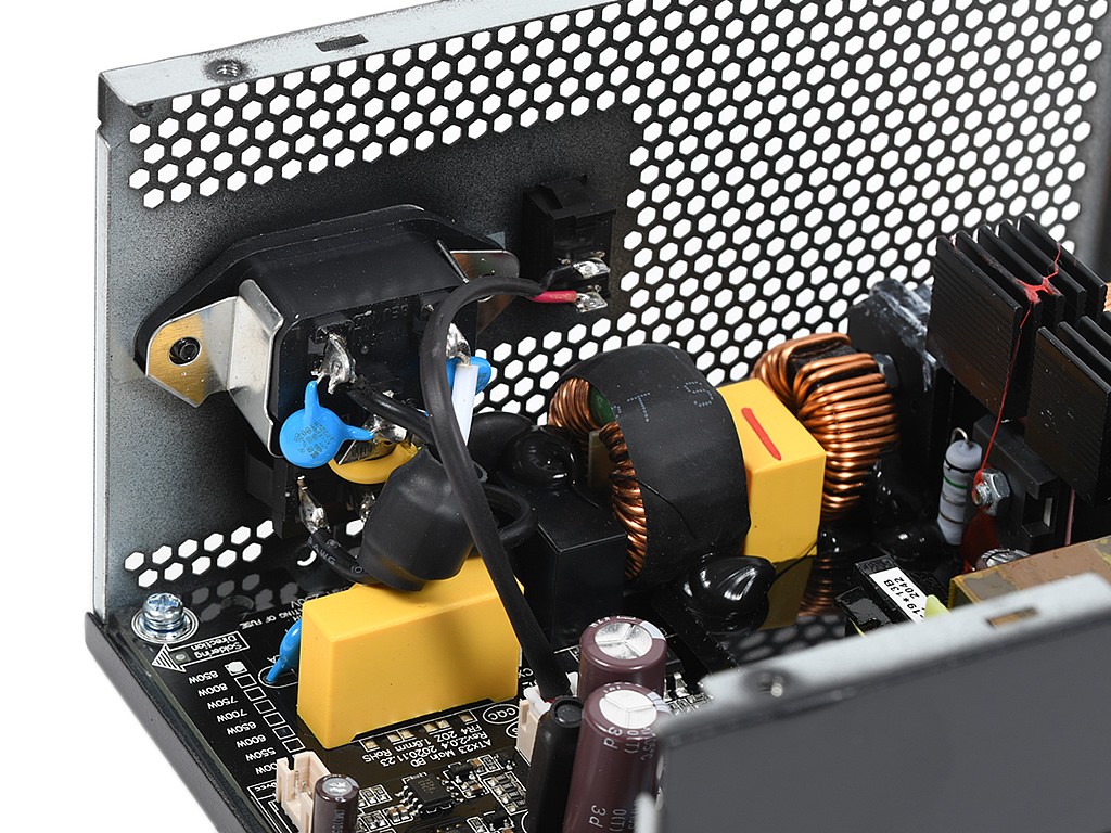

I was looking at the antec neo eco platinum today. Looks to be identical to the thermaltake PF1.
But unlike the PF1, it has a sleeve bearing fan. And it might actually have a MOV? Forgive me if I'm wrong as often the MOV is on the board near the chokes and Y caps, but it looks like there's a MOV right behind the ac receptacle. If there is a MOV there, that'd prolly be a pretty big boon for the antec....if it wasn't for there terribad customer service.
Do correct me if I'm wrong though.
