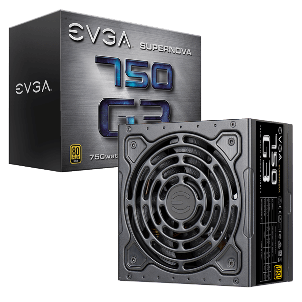

Feb 15, 2019
https://www.amazon.com/EVGA-Superno...+supernova+g3&qid=1551222092&s=gateway&sr=8-3
I have this and it's pretty small, fully modular with 80+ Gold, and a 10-year warranty. You can get it on Amazon for $102.95 free shipping.

If you get another 1000W+ PSU, it's very likely it will also have the same sparking "issue", as they have larger capacitors/inrush current.
Since your system doesn't need it, save yourself some money and get one of the 750W ones mentioned above. You can also go lower than that, but I don't recommend it, especially because you will not see much cost savings from it.
