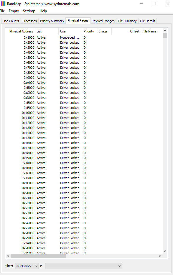

try running this, it should help identify what is using ram = https://docs.microsoft.com/en-us/sysinternals/downloads/rammap
it needs ram itself to run but use it after the game to see if it shows whats using most.
Here it is. I just forgot to tell you that i did that before... i can't see where those 6 gbs of mapped files are
mapped memory - 3.5gb of that ram is on standby, its not being used , it is free for other uses so really only the 1.5gb is being used
its very similar on my pc
really, you have 16gb total, 5.4gb in use and 3.6 in waiting, difference is likely split between zeroed and free
nothing unusual here, I would run it in background and see what it shows if you do notice ram increasing. Need to compare normal usage to abnormal to see where differences are.
