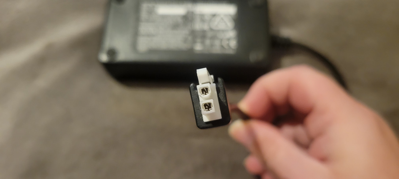

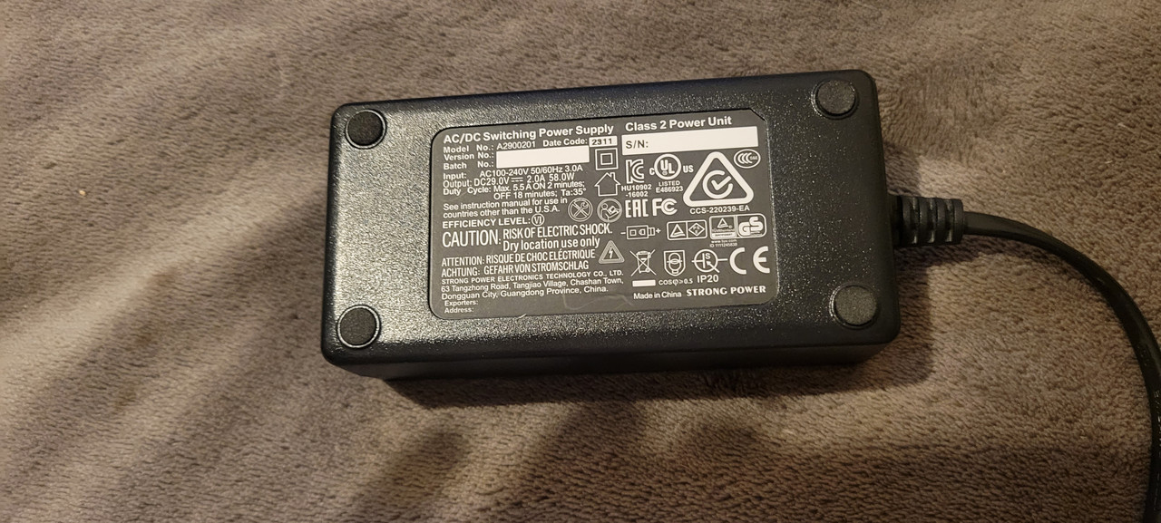

Hey everyone so I've noticed I been having some issues with my sit stand desk like the power would disconnect and then it would flash red at me and beep once.
After some investigation I found the issue to be this Molex mini fit power supply.
I've looked bug cannot seem to find anything as a replacement.
Images of power supply and connector below
https://i.postimg.cc/43SwqzcY/20231210-225839.jpg
https://i.postimg.cc/hjHXkGM8/20231210-225859.jpg
If you want a pic of the controller ( uo down buttons) as well please let me know .

First, contact the desk manufacturer for repair parts. Failing that, you may have to get a replacement 29V power supply. There are lots of them on Amazon. You would then have to splice the existing connector to the new supply.
