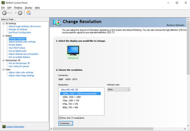

PC doesnt use same timings as xbox
it is also documented in your TV manuals
video timings :1080p (under CTA-861)
PC timings : 768p (under VESA)
CTA timings are used for media players
VESA timings are used for PC monitors
Since you have HDTV, then u should use HDTV resolutions (CTA-861)
HDTV resolutions u can switch in nvidia control panel (in case windows doesnt shows them)
1920 x 1080, 67.5 kHz/60 Hz (Full HD model only)*
* The 1080p timing, when applied to the HDMI input, will be treated as a video timing and not a PC timing. This will affect the System Settings and Display settings. To view PC content:
- Set Scene Select to Graphics
Set Screen Format/Wide Mode to Full
- Set
Display Area to Full Pixel. (Display Area is configurable only when Auto Display Area is set to Off.)
video timings are defined in EDID under CEA, PC timings are defined under VESA
to switch between CEA reoslutions and VESA resolutions, u can use geforce control panel, click on change resolution
under HD, SD u will see video resolutions, under PC u will see PC resolutions
for example mine TV is 4k, under CEA it can go 4K, under vesa its limited to 2560x1440

To view PC content:
- Set
