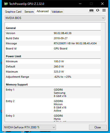

Would you recommend flashing my vBIOS? I have a feeling this might help, but i don't know anything about this and it seems to be quite risky, also i believe it voids warranty, but i don't think RMA is an option.
Current BIOS:
Personally, I'm always in favor of updating MOTHERBOARD BIOS when there is a newer, stable version, but when it comes to graphics cards I'm not in favor of it AT ALL unless there is a CLEAR advantage to doing so AND a consensus has been reached with the card manufacturers engineers (Normally through tech support) that it is a problem likely resolved by a newer vBIOS.
That isn't to say that there aren't likely instances where just doing so, independent of what anybody else thinks or does, can't be a good idea, but I'd be inclined to have that discussion with the card manufacturers second or third level tech support people first, if they are talking to you about the problem WHICH they SHOULD be regardless of whether the card is still under warranty or not. If they are not, I'd be resilient in my attempts to get them to put me in touch with those people.
I do believe the ROG forum is a GOOD resource for getting in touch with the right people, as seen here in this thread with ex-employeed Bahz, who clearly works the ROG forum and has contacts with those people still. I'm not suggesting that THAT member is the one you need to contact, merely that the right people, or the people that can GET YOU to the right people, do frequent those forums.
https://rog.asus.com/forum/showthread.php?71345-Why-is-Asus-Tech-Support-so-bad
What I WOULDN'T do is take just any regular person's advice to flash your vBIOS or do anything else in the way of modifying things, until you've had a chance to at least speak with somebody with an above average understanding of the card's architecture and history.
