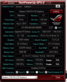

So, after many tries i was able to fix this issue with videocards by installing win7 x64. It seems, that mine win10 x64 has some errors in registry or something like this.
PS I`ve got almost 24000 in 3d mark firestrike 1080p test. So, i`m happy now))

Its done.I managed to crossfire them.Damn drivers.WAS THEIRS FAULT.Ddu the AMD drivers with one VGA in SECOND pci-e.Restart.Windows finnaly recognized the VGA in second pci-e slot.Instal second VGA in FIRST pci-e slot.Restart.Windows recognized both VGAs.Install AMD drivers.Restart.And voila.2xRX 470 crossfired.THx for help Alpo.
