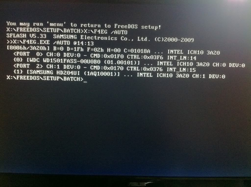

It's connected to the 2nd SATA port on the mobo but I say it is port #2 also because I did a scan in SFLASH and that's what it revealed. I did go into BIOS and change it to compatibility mode.
It appears that F4EG is hard coded to update the primary master IDE drive.
AISI, you need to swap the positions of your two drives.
At the moment the WD drive is the primary master (I/O port 0x1F0, IRQ14), and the Samsung is the secondary master (I/O port 0x170, IRQ15).

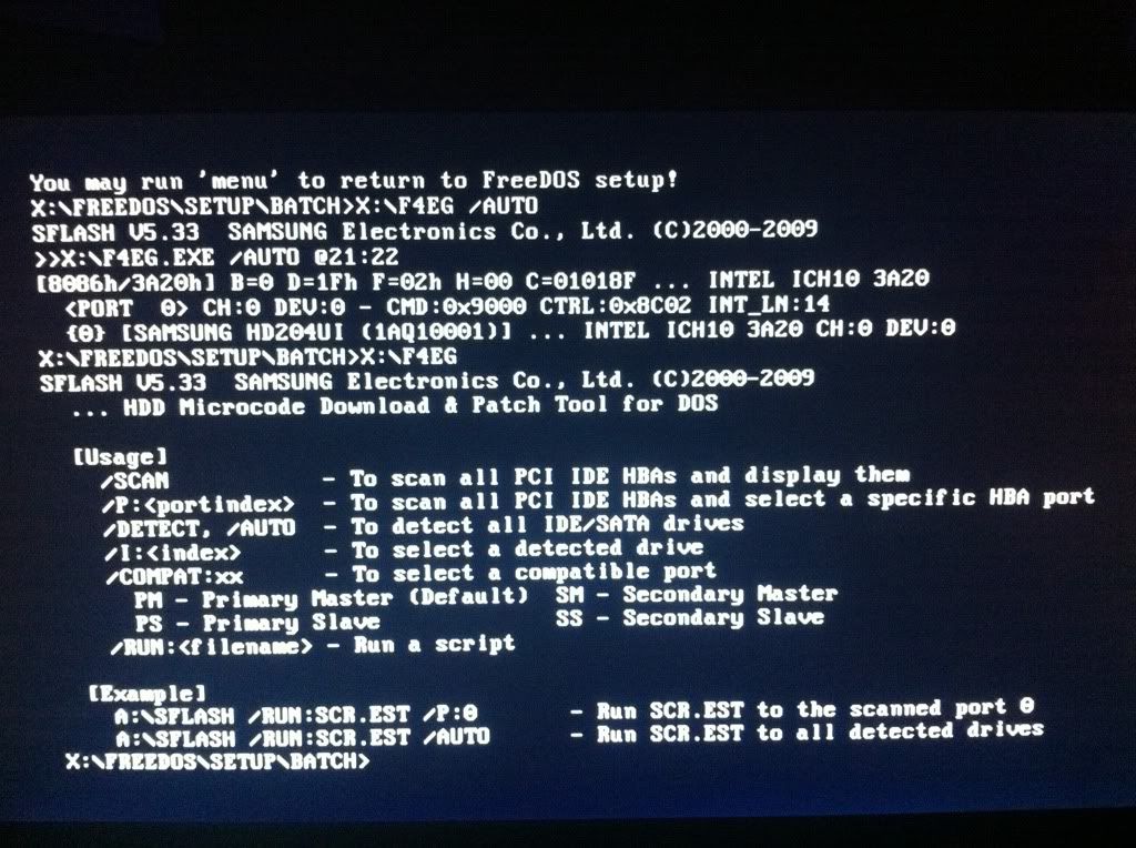

After several attempts of trying this, I was able to re-flash successfully. I made sure:
-All USB flash drives were disconnected
-No other HDDs were connected except the Samsung
-The Samsung drive was plugged into 'SATA1' on the mobo
-The SATA configuration was set to 'Compatible' in the BIOS
This time the FREEDOS boot menu was actually a little different for me while getting to command prompt than what I was given during the unsuccessful attempts. I knew something was up when I didn't get the usual 'X:\FREEDOS' in command prompt either; all that was there was a 'X:\'. I just typed 'F4EG' and hit Enter and watched it successfully do it's thing. Here is a screen shot:
http://img.photobucket.com/albums/v234/Wiznaz/a3b64981.jpg
http://img.photobucket.com/albums/v234/Wiznaz/20f9063f.jpg
http://img.photobucket.com/albums/v234/Wiznaz/884bbc87.jpg
