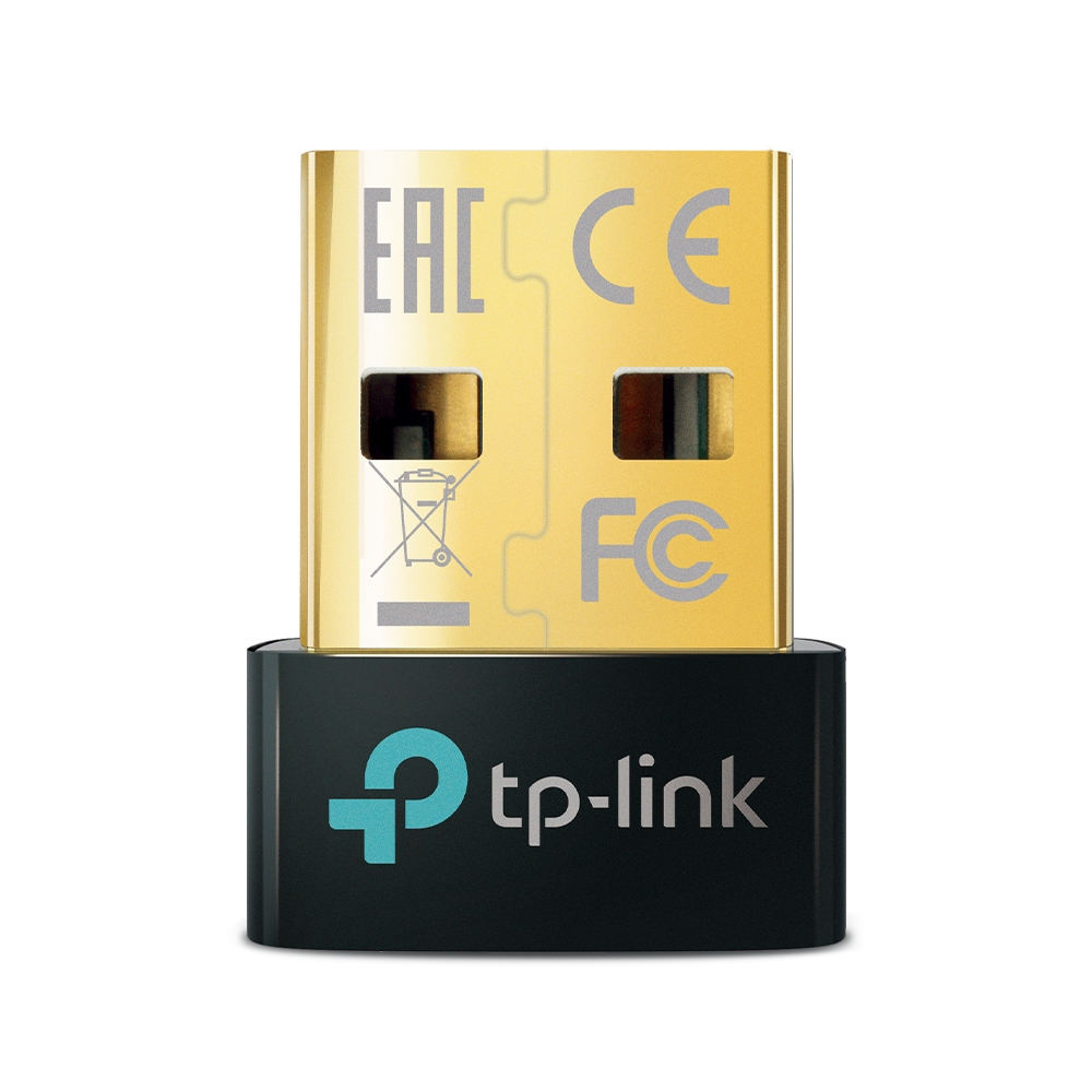

A bluetooth dongle is just a tiny usb plug-in that provides fast blutooth access for everything.
Alright, I'll get that. I do really wonder what happened, though, WiFi works fine, antennas are in etc.

A Bluetooth USB dongle connected to the front panel of the computer should help reduce the separation to a minimum and improve signal strength. There are several different Bluetooth radio standards, some with lower latencies and better HiFi quality audio. Make sure you match the dongle with your audio device. Cheap dongles operate on Bluetooth 4, but Bluetooth 5 and 6 devices exist.

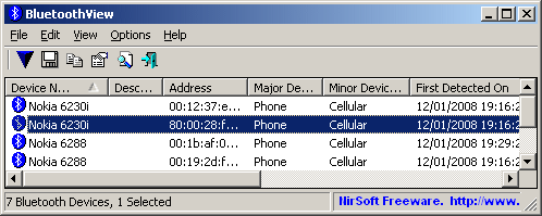

If you have a smartphone or other device nearby with Bluetooth switched on, it might be generating interference. Download a copy of Nirsoft's Bluetooth Viewer and monitor other sources in the vicinity.
https://www.nirsoft.net/utils/bluetooth_viewer.html

Those small USB dongles of any sort can get very warm and even hot.
I have noticed that USB wireless network addapters tend to get hotter with age and use. Problems begin.
Try using a USB extension cable with the USB dongle.
Two benefits: 1) you can raise or otherwise move the dongle up and about for improved transmission and reception , and 2) helps keep the dongle cooler.
