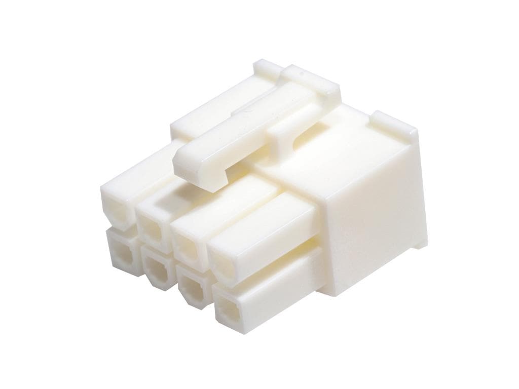

I checked the fan controller panel, i realised that the 8-pin could be reversed. On the PCB it had printed the GND and +12 V text next to the 8-pin connector, but reversed, so the GND text would point to the 4 +12 V pins row, and the opposite, supposing it uses the standard EPS connector pinout.

The 8-pin PCI-e connector of my PSU just wont fit the square/D-shape pins. However the 8-pin EPS connector fits perfect.
Check this, using the clip as reference in the 8-pin CPU EPS connector, the upper pins row (5-8) are +12 V. The lower row (1-4) are GND. Then check the actual 8-pin header in the controller's PCB and the GND/+12 V text. It looks reversed. That's what bugs me.

okay i found your problem, your connector is REVERSED, dont power it up with EPS yet
here you can see power side is at bottom, your picture shows its at top, that means that piece of plastic was inserted in REVERSE, so pull it out, rotate it and push it back in
