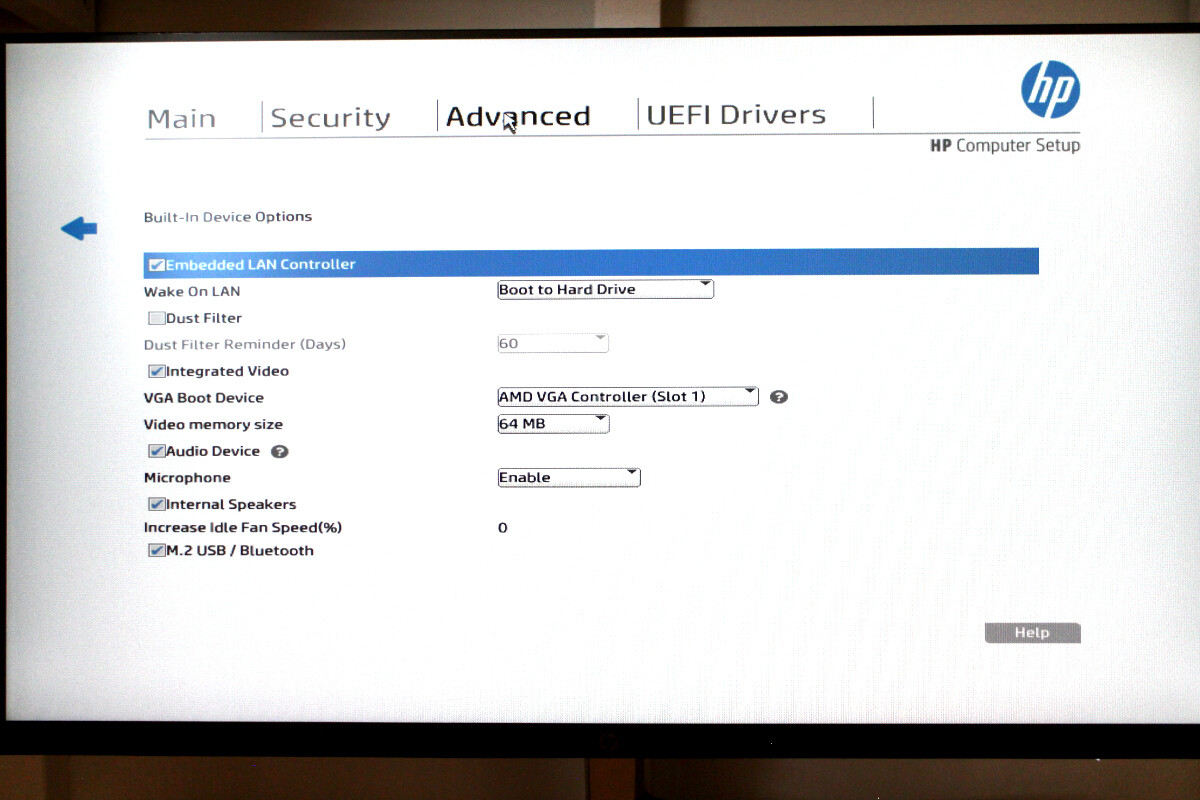

When the original video card that came with this PC is installed (AMD Radeon R7 430), you can have a monitor plugged into it and enter BIOS. You can see there's an option to select either integrated video or the AMD video card as the "VGA Boot Device."
With this card installed, the system defaults to connect a monitor to the video card and be able to view BIOS setup and info.
But when you remove this video card and install the ARC A380, the BIOS looks like this and there is no option to select the video card at PCIe slot 1:

That's not quite what happens. With the ARC A380 installed, I can't get into the BIOS unless plugging the monitor into the integrated graphics, and that's because when the ARC A380 is installed there's no option to select it as the "VGA Boot Device." But despite the BIOS settings, when the ARC is installed and a monitor is plugged into it you can boot into Windows 10 and it seems to work fine.
