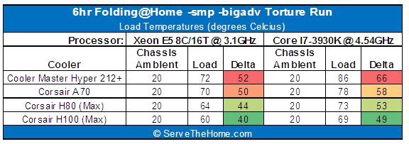

I think the hexacore isn't worth it, an alternative is to drop it to the quad core, while maintaining Hyper-Threading, and adding in liquid cooling to boost the overclock, and viewing the value of the quad core with the higher overclock, as well as the better graphics then afforded. Changes:
i7-3770k (-$230)
GTX 680 (+$100)
Corsair H100 (+$60)
Difference: -$70
H100 isn't really any better than much cheaper high-end air coolers and the i7-3770K can't be overclocked nearly far enough for it to even come close to the i73930K in highly threaded performance. It has 50% more similarly performing cores and that's simply too huge of an advantage. I also fail to see any reasoning in spending $100 more than a 670 on a 680 that will have nearly identical performance.

The problem is that, as the article pointed out, the extra cores are not used. The i7-3770k may be a bad option for the overclocking, as ivy bridge hates overclocks, but the point is still there - Can you take a quad core and liquid cooling and overclock it to perform better than the hexacores?
The GTX 670 and GTX 680 do not have nearly identical performance.
Liquid cooling provides a lot more heat reduction than air cooling.
The only thing that made any sense in your post was that the Ivy Bridge processor doesn't like overclocking, everything else was pure nonsense.
The extra cores are used in many non-gaming tasks (often the point behind very expensive builds and Tom's reasoning behind the LGA 2011 builds) and Tom's reviews of the 670 disagree with you. Also, the Hyper 212s are not high-end air coolers and the A70 is not nearly the best air cooler.
[citation][nom]blazorthon[/nom]The extra cores are used in many non-gaming tasks (often the point behind very expensive builds and Tom's reasoning behind the LGA 2011 builds) and Tom's reviews of the 670 disagree with you. Also, the Hyper 212s are not high-end air coolers and the A70 is not nearly the best air cooler.[/citation]You're right about the air cooling, Tom's Hardware's test continuously shows really big air matching mid-sized liquid.
