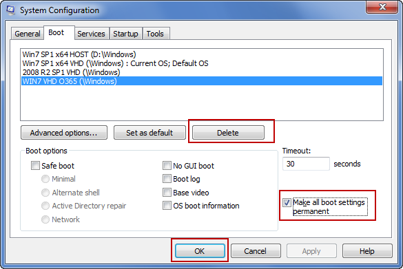

You can remove redundant bootloader entry with msconfig (boot section).
