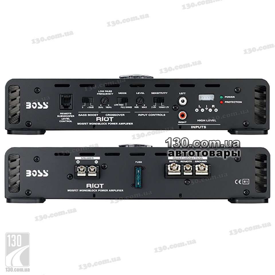

Sorry for the bad explanation yes My LOC is tapped into the factory sub and when i switch it to low pass no sound comes out here is what my amp has on it
http://130.com.ua/published/publicdata/AUTO/attachments/SC/products_pictures/Car-amplifier-Boss-Audio-Systems-R1100M-Riot_1_enl.jpg
and do i need to adjust my LOC ? What do i need to turn on this amp? and my factory head unit?
Okay I got the low pass mode to work what's a good frequency? When I turn the frequency knob they all sound the same to me....
As low as possible, while maintaining the bass range you want. You probably don't want frequencies above 120hz in your sub. If you can hear vocals in the sub, you're way too high.
