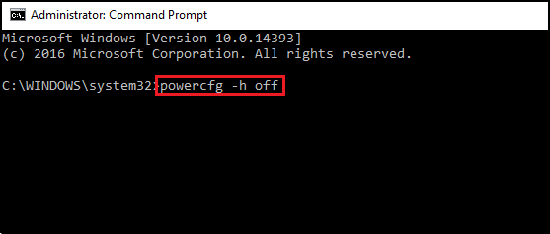

  2. Copy and paste the command into the Command Prompt window:
    powercfg -h off
    Then press Enter to disable (Figure 8).
    Windows Command Prompt
    Figure 8

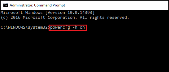

  3. Restart the computer, and go to an Administrator Command Prompt window again.
  4. Copy and paste the command into the Command Prompt window:
    powercfg -h on
    Then press Enter to enable (Figure 9).
    Figure 9
  5. Restart the computer one more time. The hiberfil.sys should be refreshed.
Once the hiberfil.sys file has been refreshed, the computer should be tested to see if the issue is resolved.
If the issue remains, go to the next step.
