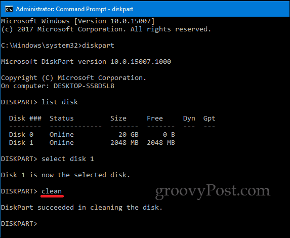

Clean the drive before installing windows onto it. Use diskpart clean method (this wipes all data from the drive).
If you have partition structures already on the disk, that are incompatible with chosen install type, then you get this error.

Please how will I get to this diskpart command prompt?
