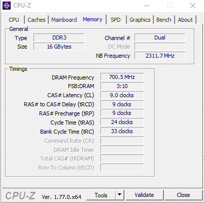

I've upgraded my RAM from (2x8GB) DDR3 1600 MHz. to (2 x 8GB) DDR3 DRAM 2400MHz
When I started the PC I got a message in all red saying that "The RAM has changed" and it gave me the option of entering set up, keep changed and continue as normal, or to restore to default settings... I chose to restore to default setting and it loaded up only to have the same clock speeds. I tried reseating the bios batt. and nothing changed. Am I doing something wrong? These are the two models: https://i.gyazo.com/4bc45a587badce02d6641639bccbc026.png
I thought that getting RAM with a higher clock speed would increase my performance in games but I tested it and so far no changes from by 1600MHz pair of RAM.
This is the new pair of 2400MHz RAM that I installed. https://i.gyazo.com/a6dc6697802a827e2fc6a7e00e6cefaa.png
Default settings for most ddr3 ram of speeds higher than 1600MHz is 1600MHz. In bios you'll have to enable XMP profile, which bumps the ram to a preset value of 2400 with the correct voltage and timings for that particular ram, as per its own bios.
