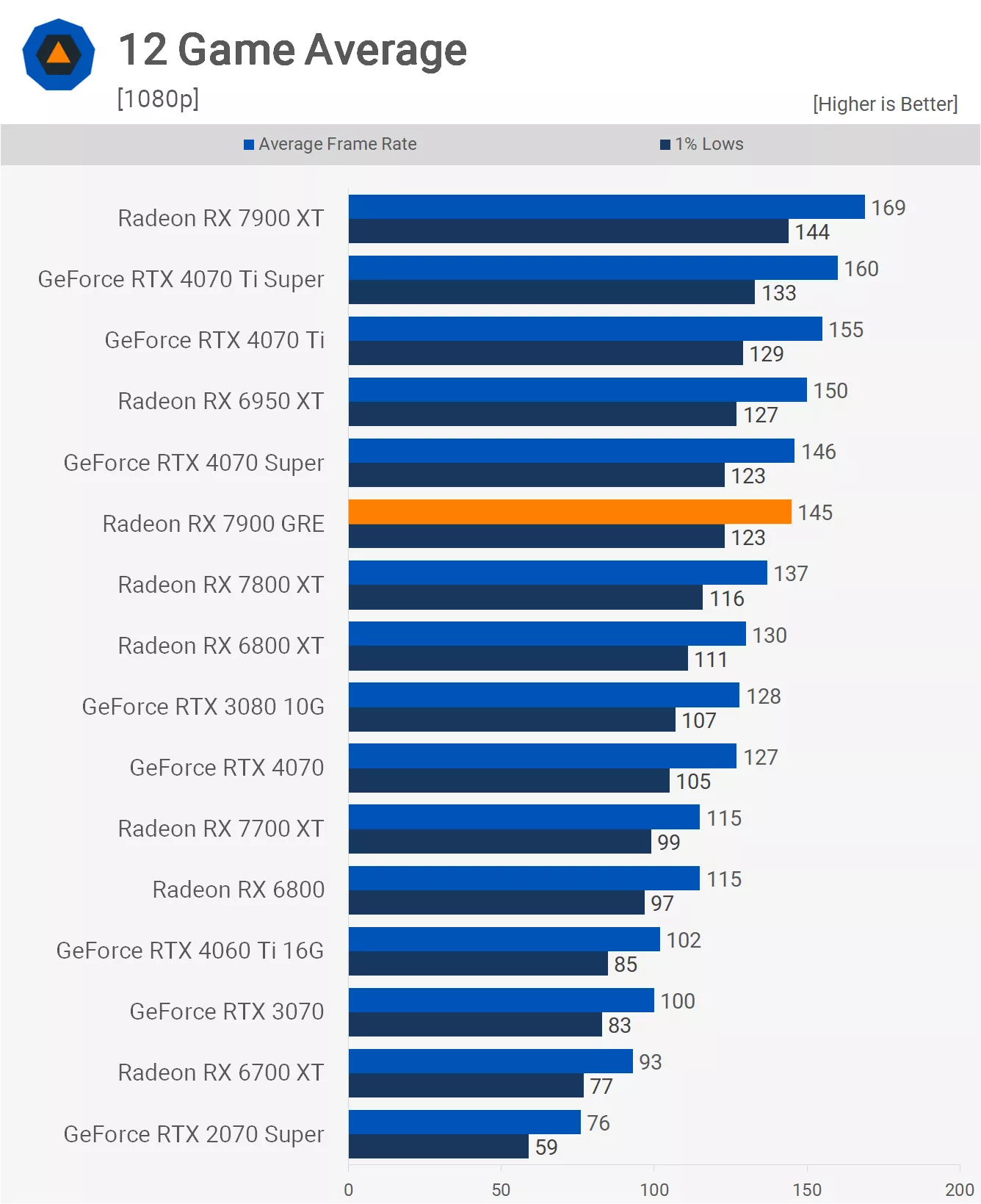

Unless you need/care about Nvidia specific features, I would be looking at AMD cards, right now. The 7900gre is faster, and similar price of a 4070, and trades blows with the more expensive 4070s. The 7800xt is slightly faster than a 4070, and even cheaper yet. Here is price a list with the price comparisons, and a PSU recommendation. More than you absolutely need, but not priced that far off of lesser wattage PSU's of similar quality.
