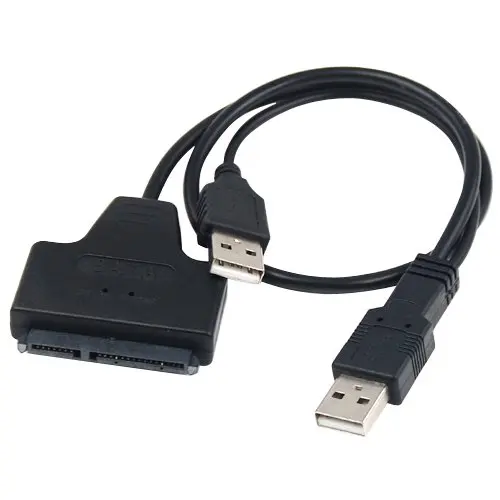

Please give us connector you used, Issue might be with low power of USB 2.0, enough for ssd, but to low for HDD to spinup.
if you're using USB2.0 you need external power OR cable with dual connector (one for power one for data) like this:
https://ae01.alicdn.com/kf/HTB1yIQmn3MPMeJjy1Xbq6AwxVXa4/2016-Nowy-USB-2-0-na-SATA-Serial-ATA-15-7-22-P-Adapter-Kabel-Do.jpg_640x640.jpg

It has 2 usb tail on that end, both plugged to my laptop, as you indicated, 1 for power ; 1 for data, has 2 lights but i guess too bright when the photo shot was taken... thx
